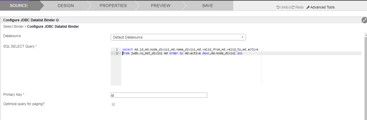

select md.id,md.kode_divisi,md.nama_divisi,md.valid_from,md.valid_to,md.active from jwdb.vw_mst_divisi md order by md.active desc,md.kode_divisi asc

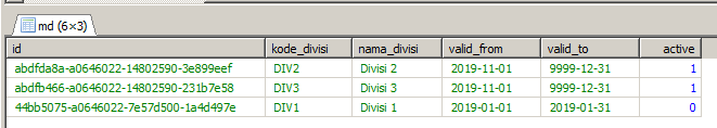

if this query execute in mysql client(HeidiSQL) then this is my result :
looking good

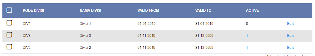

but if this query i put it in "SQL Select Query" (JDBC Datalist Database Binder) then something wrong with result
result

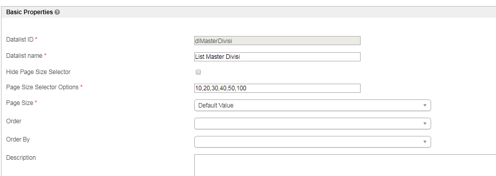

i still set datalist properties to standart
 Help me with my problem, have any idea?

      Hi
      I think you have to use the "Datalist Builder > Properties > Order" and "Order By" option fields to set the list order. Unfortunately you can only set a single column to sort.
