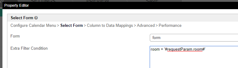

WHAT I WANT:
When room hyperlink clicked, calendar menu will show the data of this room only.

        Is this setting shows bellow not work for Calendar menu?

        It could be the condition is not correct. You can refer to Form Data Binder for the syntax to use in the Extra Filter Condition, perhaps you can try "e.customProperties.room" instead of just "room".
      7. Michael Meng
        "c_room" is OK, the problem is hash variable does not wok well.
