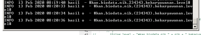

String level = "#pl.employee.employeecode.88888.level#";
output
I need to dynamic employeeCode into hashvariable
String emplCode = User.getEmployeeCode();
String level = "#pl.employee.employeecode."+emplCode+".level#";
but i have a problem
output
thanks in advance
best regard
Khafidz
      Hi, you can try using a nested hash variable Hash Variable#NestedHashVariable
      1. Muhammad Khafidz
        thank you Anders, but still not work
      2. Anders
        According to the examples in the documentation, I do not think you can use the + symbol.
      3. Walter
        The hash variable is only parsed one time. You cannot have it parsed the second time.
    2.
      I am afraid you cannot split a hash string into two or more parts, Joget hash variables is like a search and replace string function in a text editor. It will find the matching #somehashstring# and replace with the new value.
      Try this instead ( in pseudocode ):
      • Assign #pl.employee.employeecode.88888.level# to string var0
      • split value in var0 into var1 and var2
      • perform your string concat var1 + empcode + var2
      1. Muhammad Khafidz
        thank you Mattew, i have split hash variable like pseudocode
        but it still not work.
        i try hashvariable to reproccess
        it work,
