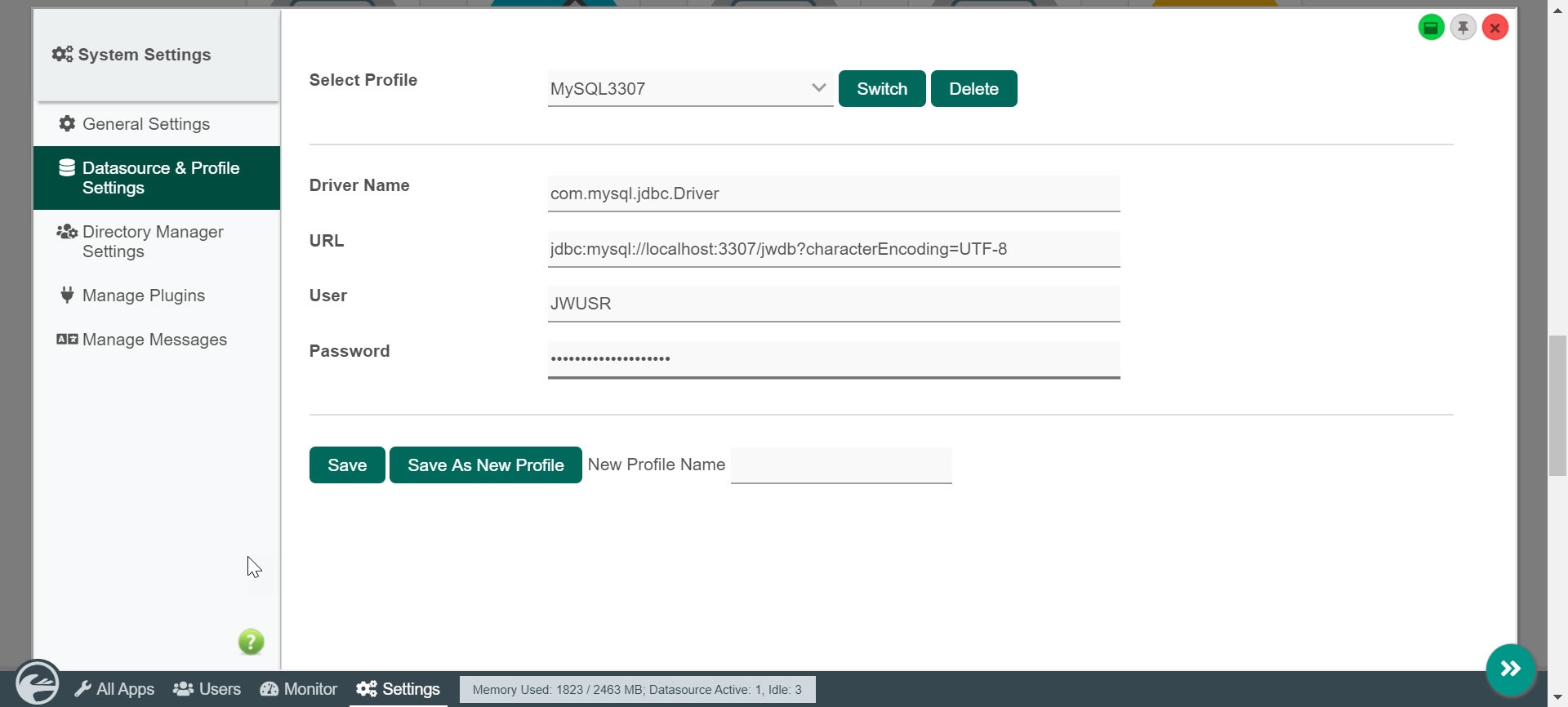

Did you install Joget with Embeded DB?
You can check in admin bar at Settings Menu then select Datasource and Profile Setting.
You could refer this configurate then try to connect DB with your tools (I prefer MySQL Workbence for this case). You change DB property from this way.

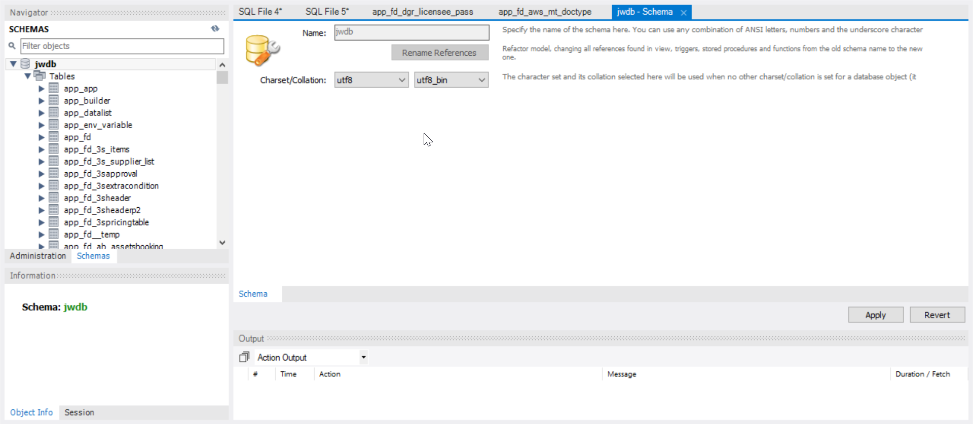

Did you check database encoding format?
Normally maria or MySQL was created database with "Latin" encoding but I think Chinese should be different Encoding (our language is Thai so we usually setup to "UTF8" encoding.

Yes, I know it should probably encoding issue, but I have no idea how I can fix it through Joget DX panel or docker command line terminal.
I'm now use Joget DX by docker image. Not install database and main program separately by myself, so I have no idea how to fix it.
Can you share your experiences about how to change default database character set?
