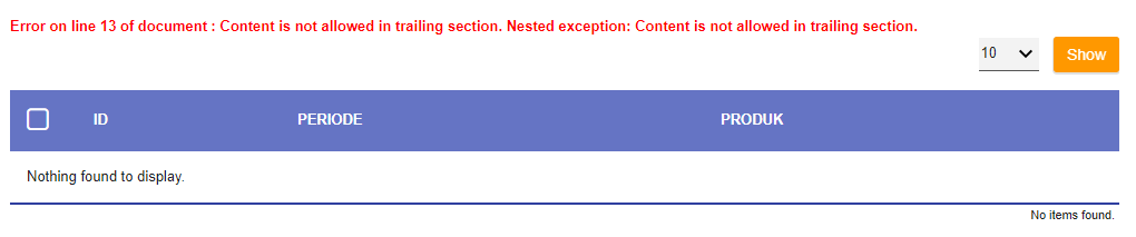

I did put Bean Shell Formatter in a datalist column to show thousand separator
import org.joget.commons.util.StringUtil;
return StringUtil.numberFormat(value, null, null, null, true, "0");
But unfortunatelly, still error to connect to the table, error to create form to the table, error to make datalist filter based on the table, err to import new Apps, err to create new version.
So, i installed new fresh joget in another linux directory. And it is normal.
where can i edit the line 13 of document (Content is not allowed in trailing section) ?
Hi, you can try to check the wflow/app_forms directory, looks like one of the XML files is corrupted. If you are not sure which file you can also try to rename the app_forms directory and let it regenerate automatically.
Did you add any javascripting in your form that might have corrupted it?
Maybe you could build a new form and as you build, step by step test it on a datalist. You will know what you did wrong once your datalist fails to run and just reverse that last action.
Suddenly err to save a form, err to create datalist and err to create a connection to specific table :
Here is the error message :
ERROR 25 Mei 2020 09:51:11 FormOptionsBinder - org.hibernate.InvalidMappingException: Unable to read XML

at org.apache.catalina.connector.CoyoteAdapter.service(CoyoteAdapter.java:343)
at org.apache.coyote.http11.Http11Processor.service(Http11Processor.java:798)
at org.apache.coyote.AbstractProcessorLight.process(AbstractProcessorLight.java:66)
at org.apache.coyote.AbstractProtocol$ConnectionHandler.process(AbstractProtocol.java:808)
at org.apache.tomcat.util.net.NioEndpoint$SocketProcessor.doRun(NioEndpoint.java:1498)
at org.apache.tomcat.util.net.SocketProcessorBase.run(SocketProcessorBase.java:49)
at java.base/java.util.concurrent.ThreadPoolExecutor.runWorker(ThreadPoolExecutor.java:1128)
at java.base/java.util.concurrent.ThreadPoolExecutor$Worker.run(ThreadPoolExecutor.java:628)
at org.apache.tomcat.util.threads.TaskThread$WrappingRunnable.run(TaskThread.java:61)
at java.base/java.lang.Thread.run(Thread.java:834)
Caused by: org.dom4j.DocumentException: Error on line 13 of document : Content is not allowed in trailing section. Nested exception: Content is not allowed in trailing section.
