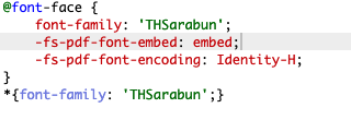

We just solved the Problem by making some tests on our local Server. We would like to share our findings as follows.
@font-face { -fs-pdf-font-embed: embed; -fs-pdf-font-encoding: Identity-H; } *{font-family: 'THSarabun';}
is the correct CSS which works for us.
The default path of fonts resist on jw/WEB-INF/classes/fonts/THSarabun/THSarabun.ttf
so we don't need to define scr:url path for the file location.
and the font-family Name must be identical with the ttf file name. (THSarabun)

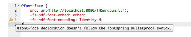

Thank you for your answer. Sorry, I should have mentioned before that I have looked at the Export Form Email Tool#Advanced and tried that markup but it gave this error:
"@font-face declaration doesn't follow the fontspring bulletproof syntax."

The lint warning you see above, after googling i find that it is just a warning to encourage you to add the same font family with all the different font format types to support all browser variants (e.g: IE, Chrome, Firefox, etc.). Unless you plan to support all browser variants, I think its ok to ignore the warning. I have no issue doing so.

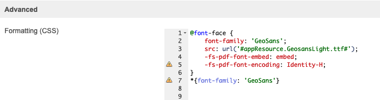

I've tested your suggestion, unfortunately it doesn't work in the "Export Form Email Tool"...
It works in the userview though. So the font-face syntax is working there. I still can't change the font for the PDF.
Pdf compared to userview requires additional codes to work.
Does your code look like this sample snippet below?
@font-face { font-family: 'TH SarabunPSK'; src: url(#appResource.THSarabun.ttf#); -fs-pdf-font-embed: embed; -fs-pdf-font-encoding: Identity-H; } *{font-family: 'TH SarabunPSK';font-size: 20px;}

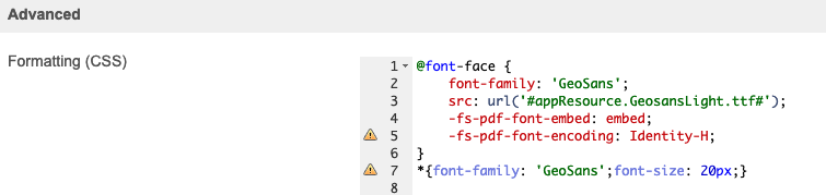

Yes, it's the same, apart from the font-size - I don't want to change the font size:
I have tried some other fonts too, the font never changes.
This code only changes the font-size, not the font:

@font-face { src: url(http://localhost:8080/THSarabun.ttf); -fs-pdf-font-embed: embed; -fs-pdf-font-encoding: Identity-H; } *{font-family: 'TH SarabunPSK';}
Note: Download the THSarabun.ttf font file and copy it to "[Tomcat Directory]/webapps/ROOT" folder.

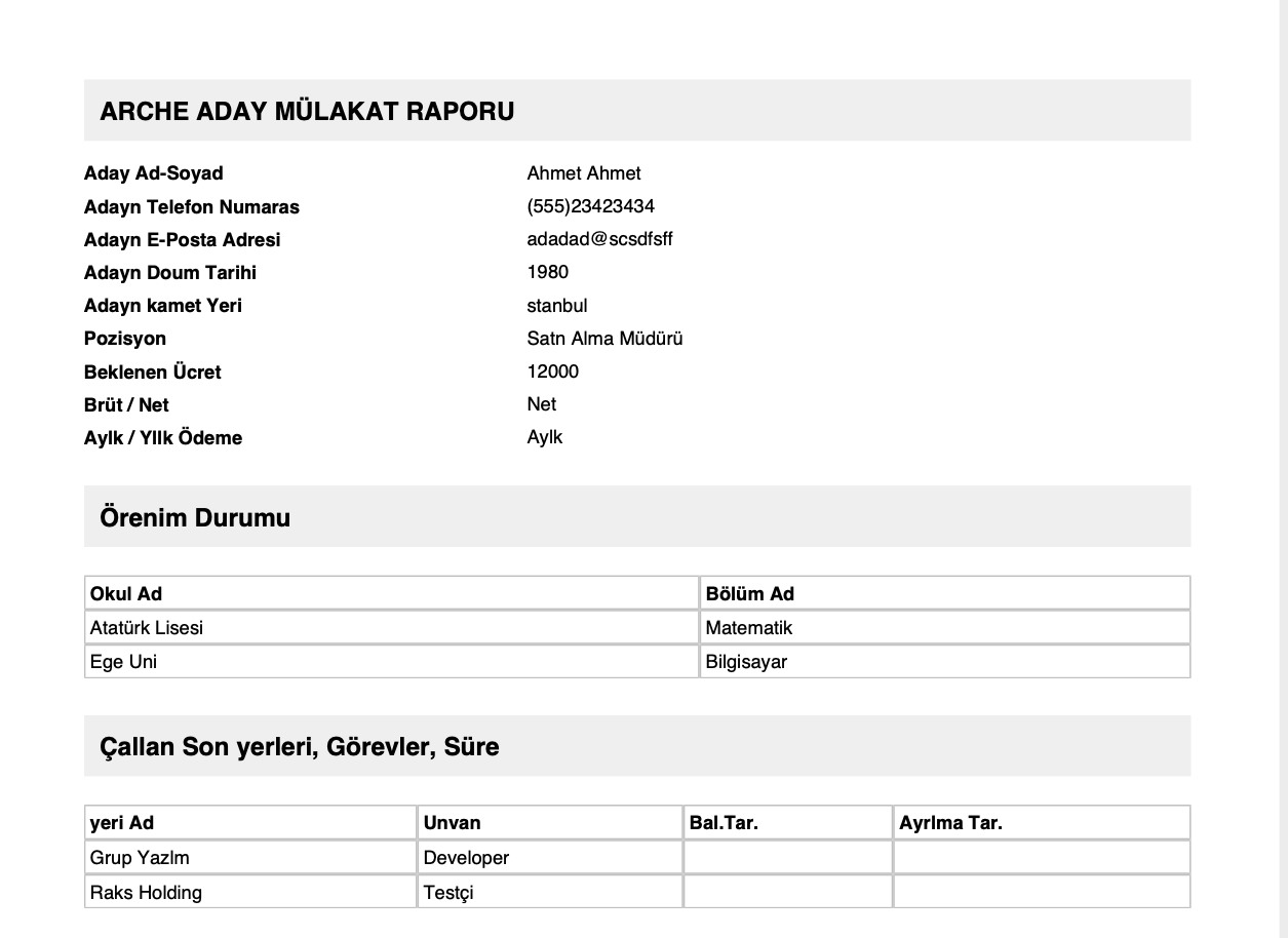

We have a Joget DX On-Demand subscription and I am trying to use the "Export Form Email Tool" and having problems with Turkish characters in the PDF.
The Turkish characters such as ı, ğ, İ, ş are not shown in the PDF. For example at the fourth line the header "Adayn Doum Tarihi" should have been "Adayın Doğum Tarihi". By the way we have no problem with Turkish characters in the application ( in the forms or datalists or with the "Print" option ).
