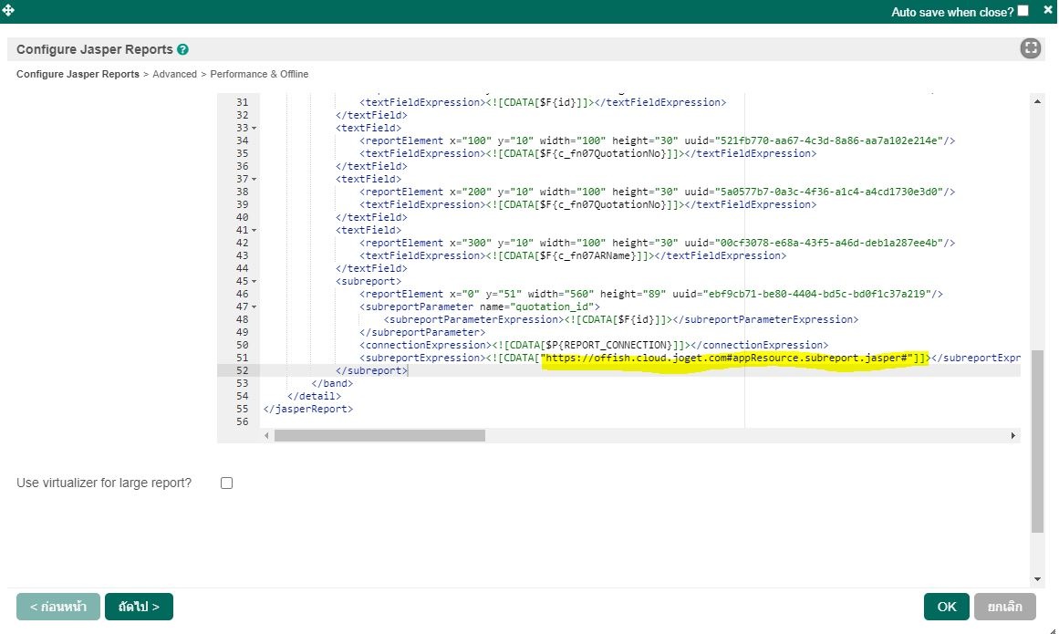

Dear Sirs,
How can I call subform from TIBCO Jaspersoft in my project. I try to run it, I add 'subreport.jasper' file in Resource menu. Then, I call '#appResource.subreport.jasper#' fail, it show 'net.sf.jasperreports.engine.JRException: Error opening input stream from URL: https://offish.cloud.joget.com/jw/web/app/finance/resources/
subreport.jasper.'. How can I fix this problem.
Best Regards
