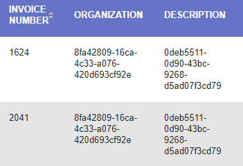

In the Datalist Builder > edit the columns organization/description and use the formatter. Assuming both columns comes from a lookup, use options value formatter
In the data list column go to option formatter select jdbc and same query you write there and save.
Hello, I have 2 popup select boxes in my form. Data from the popup select boxes displays in datalist like ID.
I would like to ask, how can I to display for instance title instead of ID.
Thank you
