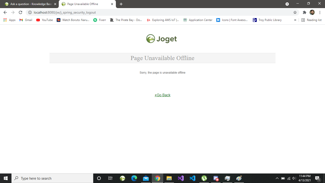

Whenever I start joget server, it opens and closes automatically and when i try to login at http://localhost:8080/jw/home/, it gives me the message "Page Unavailable" or "Localhost not found"
I have tried re-installing and any related fixes I could find.
I installed JOGET on my PC and it is working fine but this happens when i try to start it on my laptop. I don't know if windows security essential is terminating the app or is there some other issue. If someone could help. I'd be grateful. Thanks
