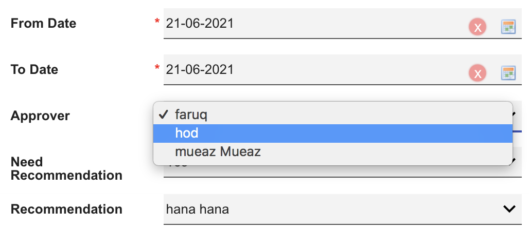

ohh interesting. So When create user, need to setting who are HOD for each department/division?
When requester select department/division, go direct to HOD?
yes, if you have participant from other datasource or table, you can use this code.
I put user must be select the HOD for approval

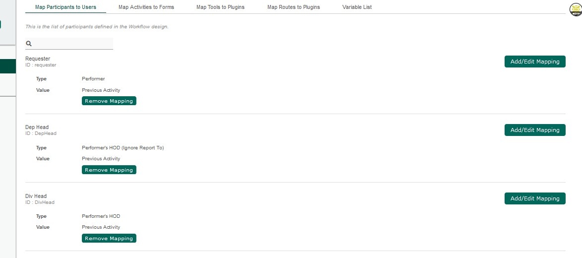

I've already create process, assign "report to" and "assign HOD". After run the process, approval not go to division head, it stuck to performer. Here is my Process and Participant :
Hi, you can design your process with Process Routes, and directly transition to the division head approval activity based on your specific conditions.
I have org chart in IT Division, Staff - Sec Head - Dep Head - Div Head.
I want to know how if the staff requests something, the approval goes directly to the division head?
