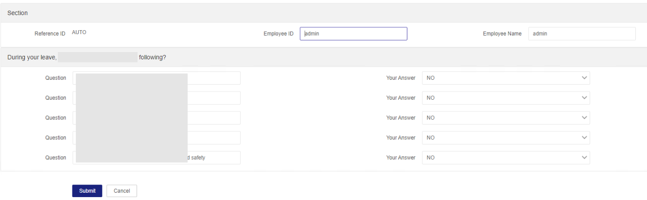

I'm working on Joget form, the main intension of the form is to collect answers from end-user with questionnaire. I'm unable to achieve the logic as mentioned in subject.
I created multiple read-only fields (for Questions & Answers) with same FORM ID with the assumption that multiple questions along with their answers loaded into database table as rows when user hit SUBMIT. but it's only loading first question and answer database table, I think it will work when we create each question as separate column (filed in Joget form), to capture all questions response, but that would be poor design, we cannot change column name or add new column as the question description changes.
Kindly advise, if there is any workaround. following screenshot for the reference
