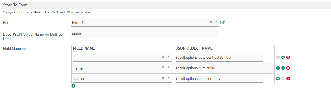

Hi, from the response it's not clear which data is repeated. Assuming the "puts" is repeated, perhaps you could try using "optionChain.result[0].options[0].puts" as the Base JSON Object, and just "contractSymbol, "strike" and "currency" in the field mapping.
How would I setup the JSON Tool to capture: Puts values ContractSymbol, strike and currency when I receive the below compacted result of my API call??
I have tried with this, but no luck:
