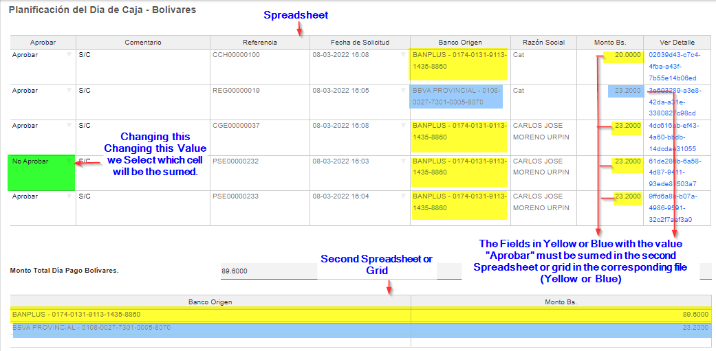

I´m needing an example, to sum a series of selected cells in a spreadsheet in another spreadsheet or in a grid in the same form.
In this example, I´m trying to describe the requirement.

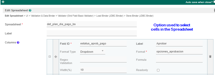

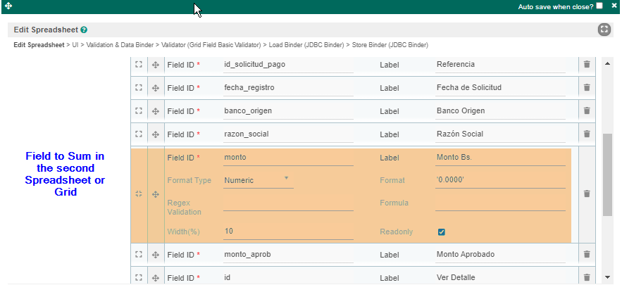

Spreadsheet configurations
