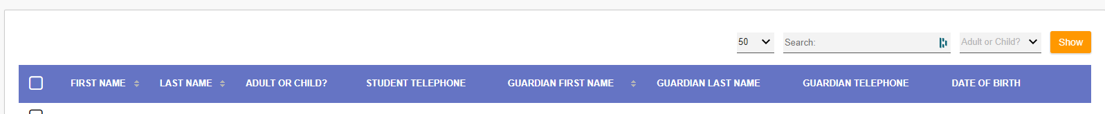

The way I am envisioning it is as follows, please see screenshot below:
I already use the fulltextsearch marketplace plugin to be able to serch on multiple fields. I would like to be able to see filtered results as I type - for example, as I start typing a guardian last name (or for example from 3 characters onwards), the results showing on the table are filtered accordingly, without the need to press the Search button.
I hope this make sense.
