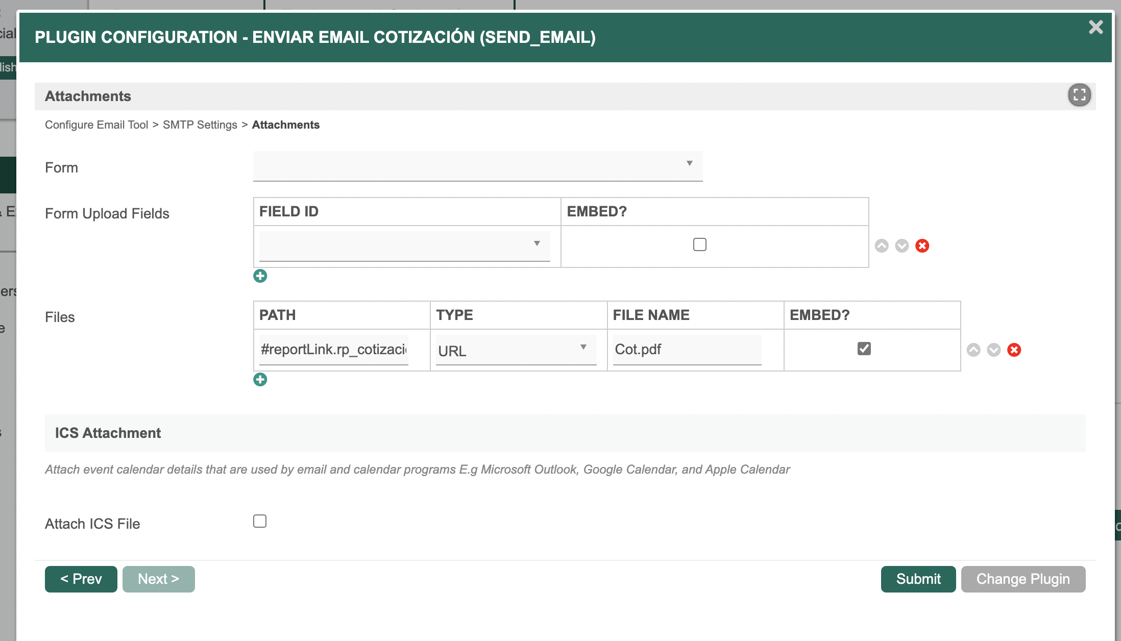

Hi, im using the hash variable of report builder to bring in a email an attached PDF but the server say this when i try send the email.
and the hash variable is #reportLink.rp_cotizacion[id={variable.email}]#
Caused by: java.io.IOException: Server returned HTTP response code: 400 for URL: https://clasealpha.cloud.joget.com/jw/web/json/app/acomercial2022/1/plugin/org.joget.rbuilder.lib.ReportLinkHashVariable/service?_rid=rp_cotizacion&_params=%25%25%25%25hqYhV%2FNcu%2B0lWLAm8jMzwGsrvh6Zo2Cs%25%25%25%25&_nonce=%25EF%25BF%25BD%25EF%25BF%25BDhv%25EF%25BF%25BD%257Ee%251B%25DC%25AA
Help Please
Hi, if you are getting a 400 Forbidden response, I believe you need to set the API Domain Whitelist in the General Settings#SystemAdministrationSettings.
