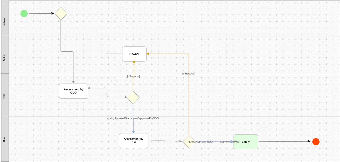

1. approver sends the status to rework - the task is not assigned to the whole department.
Was it working before in earlier version?
Which swimlane?
It was never working - it is reproducible - swimlane = author. Expectation would be, it would be assigned to "Author: Performer's Department" as defined in the actor permission management.

In Community Version (7.0.31) on docker I have setup a process with 4 lanes with the following assigned Mappings:
A department was created with 4 users, user 1 was assigned the HOD role.
User 2 initiates the approval process. It reaches the approval for HOD. But when the 1. approver sends the status to rework - the task is not assigned to the whole department.
Expected outcome would be - all 4 users in the same department like user 2 (initiator) should see the task.
