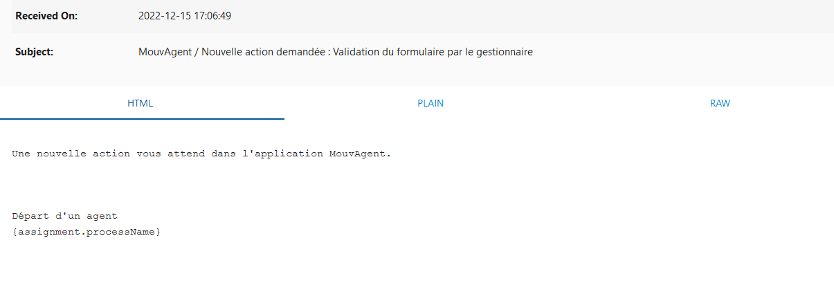

In fact, I have already changed the expression with quotes to have :
#exp.'{assignment.processName?expression}'.isEmpty()?'empty':'{assignment.processName}'#
And the response is

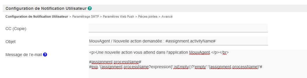

add single quotes for the else statement
from
#exp.'{assignment.processName?expression}'.isEmpty()?'empty':{assignment.processName}#
to
I have a problem with hashvariable in notification.
You can see below :
#assignment.processName# = "Départ d'un agent"
If I use #assignment.processName# alone, no problem.
If I use the expression #exp.'{assignment.processName?expression}'.isEmpty()?'empty':{assignment.processName}#, the hashvariable assignment.processName is unknow.
