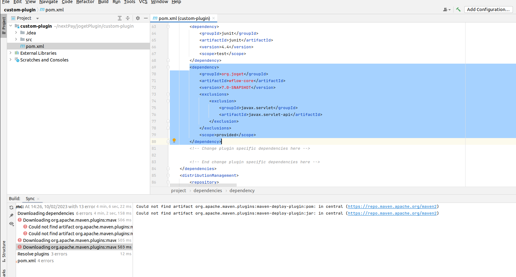

HI Anders Thanks for your help me create new plugin but
While I run Docker command to create new plugin and open Project in IDE. Exiting not found with
<dependency>
<groupId>org.joget</groupId>
<artifactId>wflow-core</artifactId>
<version>7.0-SNAPSHOT</version>
<exclusions>
<exclusion>
<groupId>javax.servlet</groupId>
<artifactId>javax.servlet-api</artifactId>
</exclusion>
</exclusions>
<scope>provided</scope>
</dependency>
How can I to do next. Thanks and regards
Hi, did you set up your development environment first? You will need to build the project first following instructions from Joget Open Source. Alternatively you could try Build Plugin Source Code using Docker.
