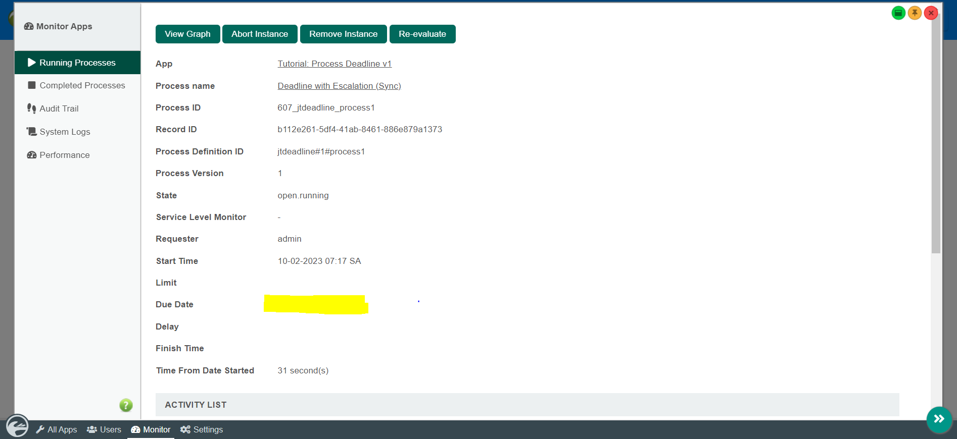

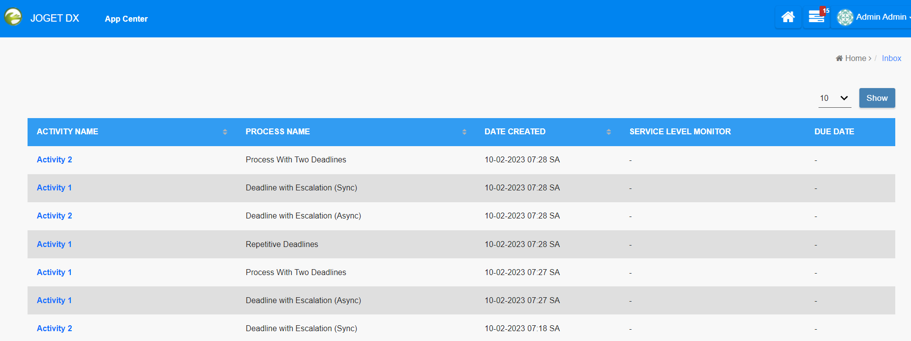

I downloaded Tutorial app "Tutorial App: Process Deadlines" https://marketplace.joget.org/jw/web/userview/mp/mpp/_/vad?id=APP_jtdeadline-1 and was able to run all processes (without changing anything from the app). However, when visiting inbox or monitor page, I couldn't see the Due date information.
Inbox: No information in Column Due date
Activity instance detail: No information in Due Date
