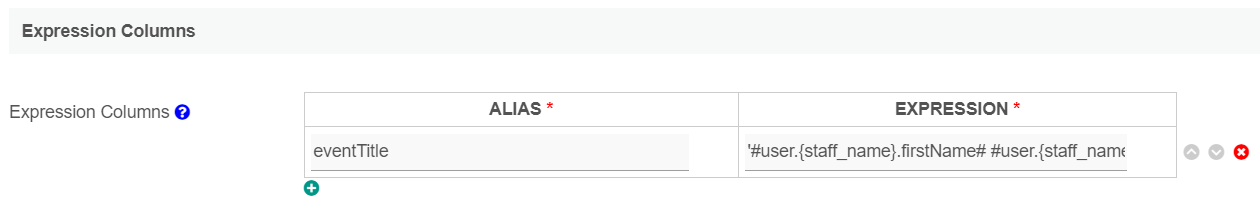

I don't think the hash variable will work in an expression column.
Instead JOIN your table on username to the "dir_user" DB table to get the first/last name into the selection, and use "CONCAT(d.firstName, ' ', lastName) as title" function to build the title description. See Advanced Form Data Binder#ExpressionColumns.

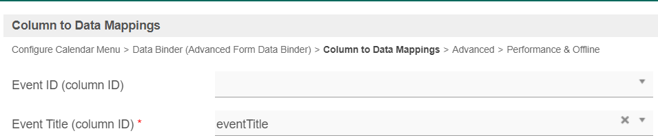

How do I use hash variable to display the Staff Name in First Name and Last Name format in the event title?

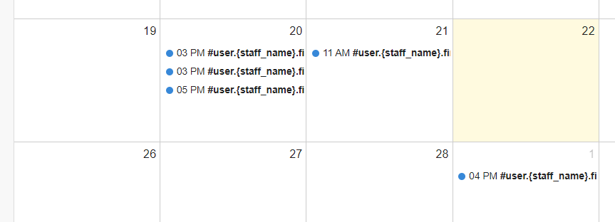

I tried the following format but it's not showing properly in the calendar ('#user.{staff_name}.firstName# #user.{staff_name}.lastName#')
