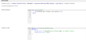

Go to "App Center > Userview Builder > Joget DX > Settings > Home Banner & Custom CSS" and change the "<img src=...." code to point to your image that is stored in "Properties & Export > Resources" or any outside hyperlink.
Hi Matthew, I had done change the background but the size being small and compress for the image.

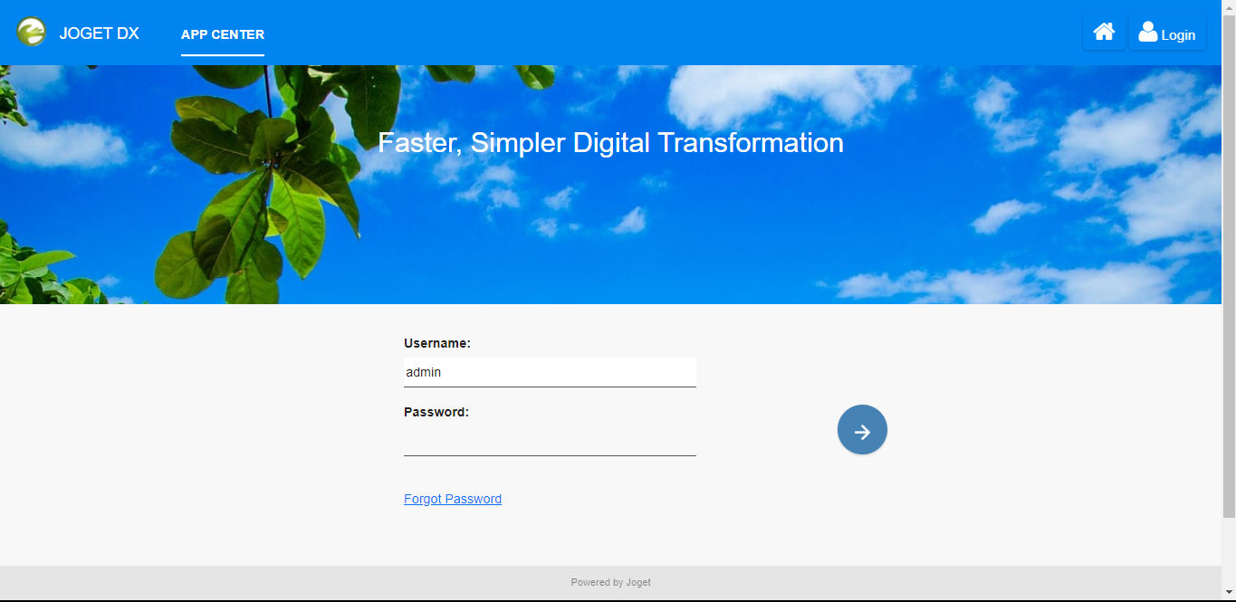

2. I cannot found how to remove the word Joget DX Platform because I want company name in the system
As for the 2nd question, you can just the title in the userview builder.

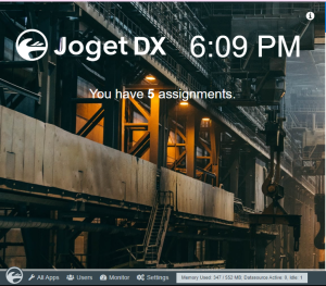

Hi, can i know how to change wallpaper background, the logo joget dx 7 and app center for custom?
