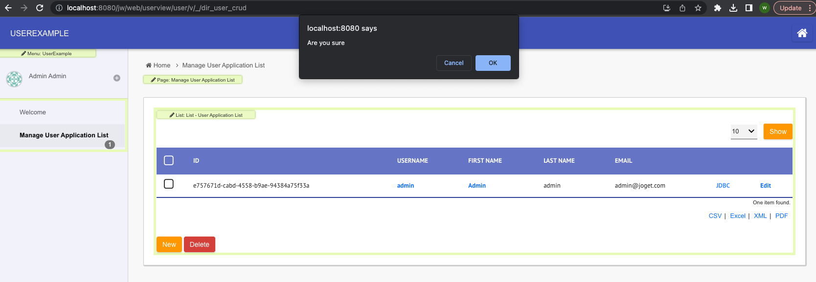

However, let me explain how I set up a similar application using Joget DX Enterprise Version: 7.0.36
Step 1: This is the datasource.

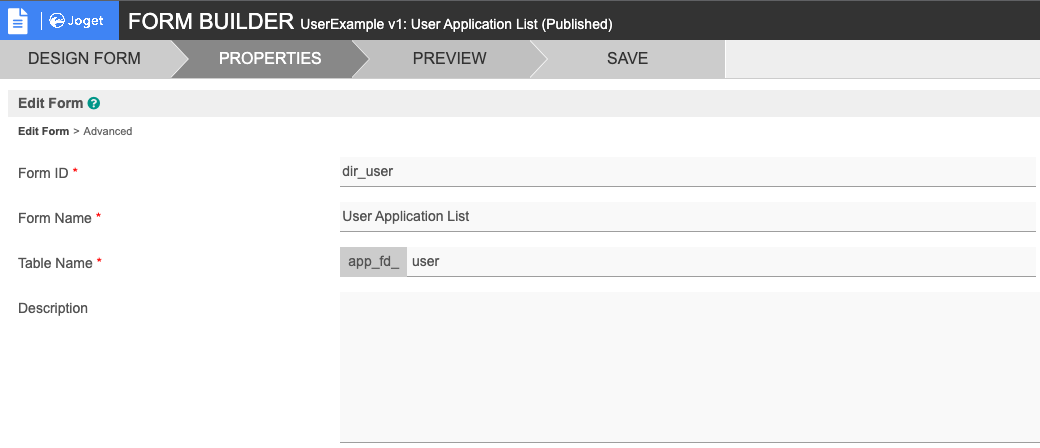

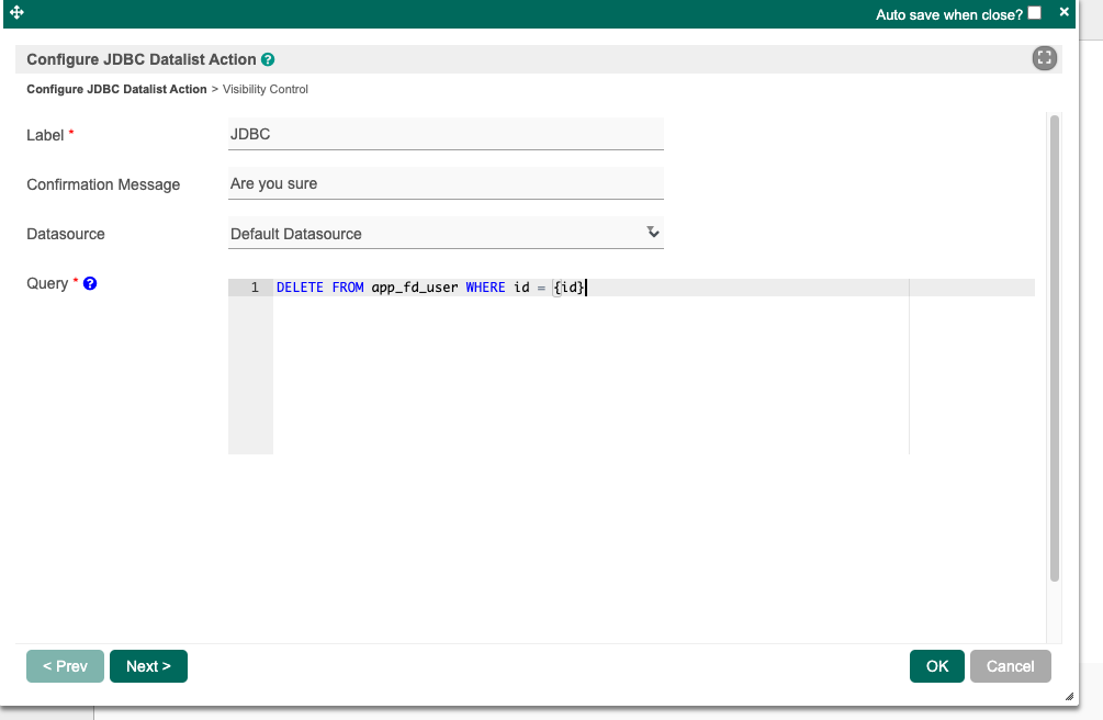

Step 2: In the JDBC query, I specified the table name as "app_fd_user". For example, the query would be: "DELETE FROM app_fd_user WHERE id = {id}".
Step 3: And I have successfully been able to execute this action.

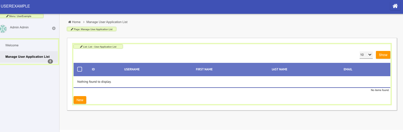

Step 4: And it successfully deletes the row.

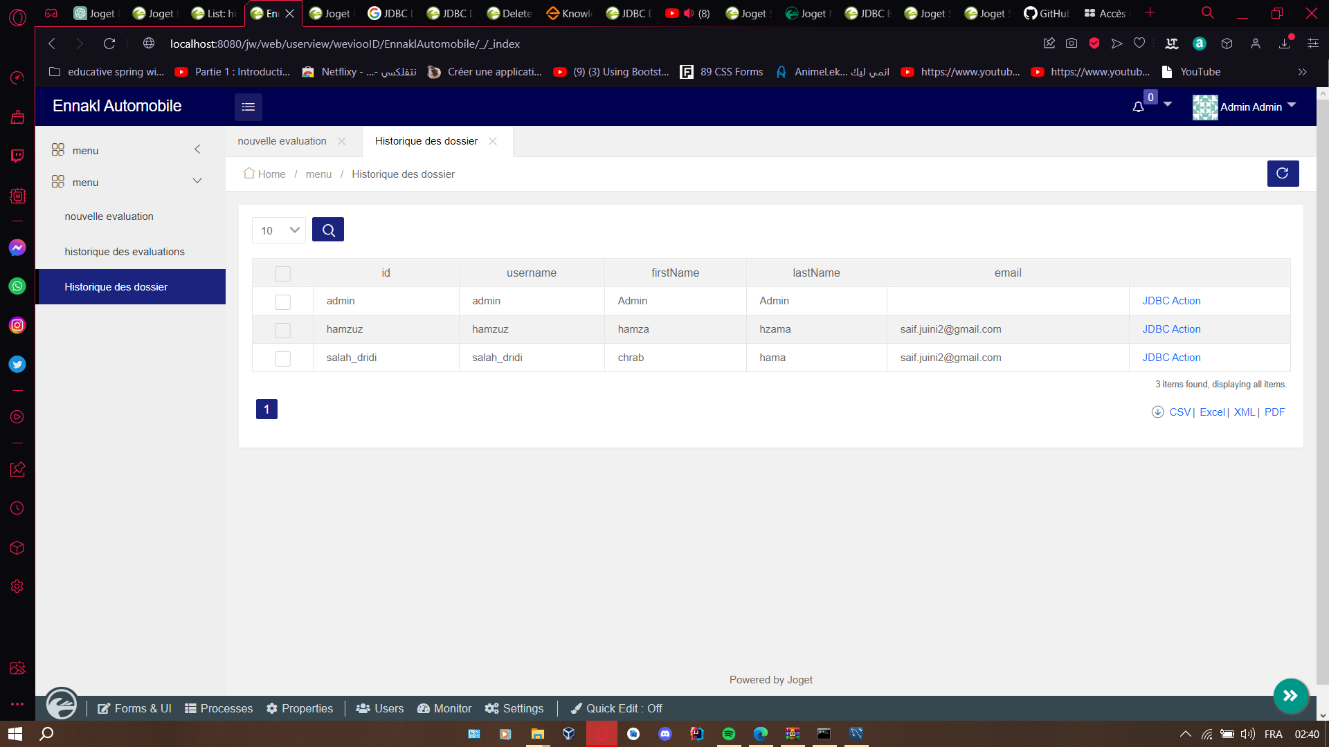

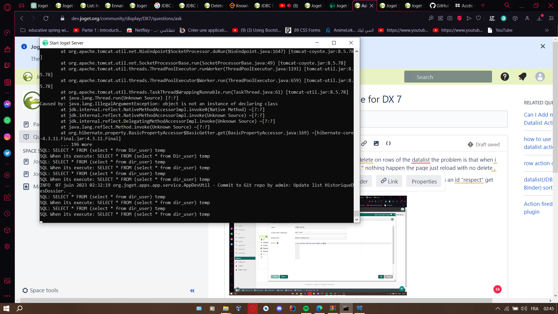

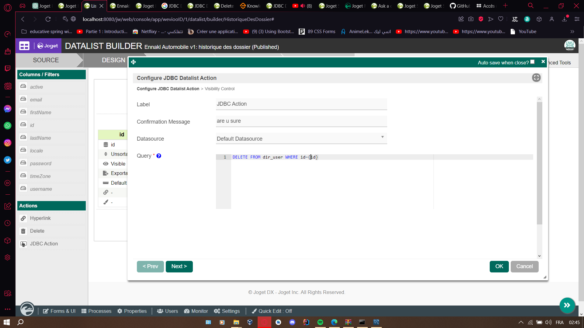

im using a jdbc action binder im trying to perform a delete on rows of the datalist the problem is that when i use this query "DELETE FROM dir_user WHERE id={id} " nothing happen the page just reload with no delete ,
in fact when i use this querry "DELETE FROM dir_user WHERE id='respect' " the user with an id "respect" get deleted
