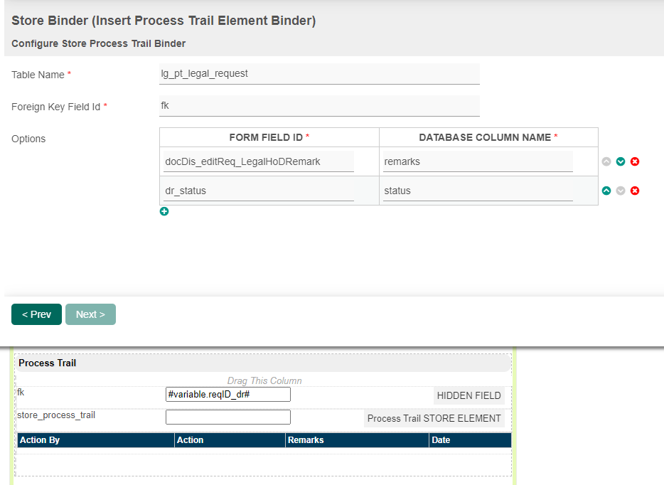

Currently I have an app which uses process trail in the workflow, im trying to store the approval status done by the user/approver for each form but its not working as it is not getting inserted into the DB and nothing is showing up in the process trail element.
Logs file says nothing about inserting into the DB. I have no form that this table call lg_pt_legal_request but i created one in the DB.
Hello. Did you create the table exactly following the table and field naming protocol (app_fd_****** and c_******)? I would suggest that you create the table via Joget and do some inserts through a form into a userview so that the table is fully created and then test again.
i have created a form that use the table that i have created, but whenever i place the form in the mainform as a subform, it will break the form. Not sure why that happens.
Where did you get the plugin from? It looks unfamiliar to me.
Oh, its a custom plugin, well i thought its from joget, but after double checking, it seems to be custom build.
