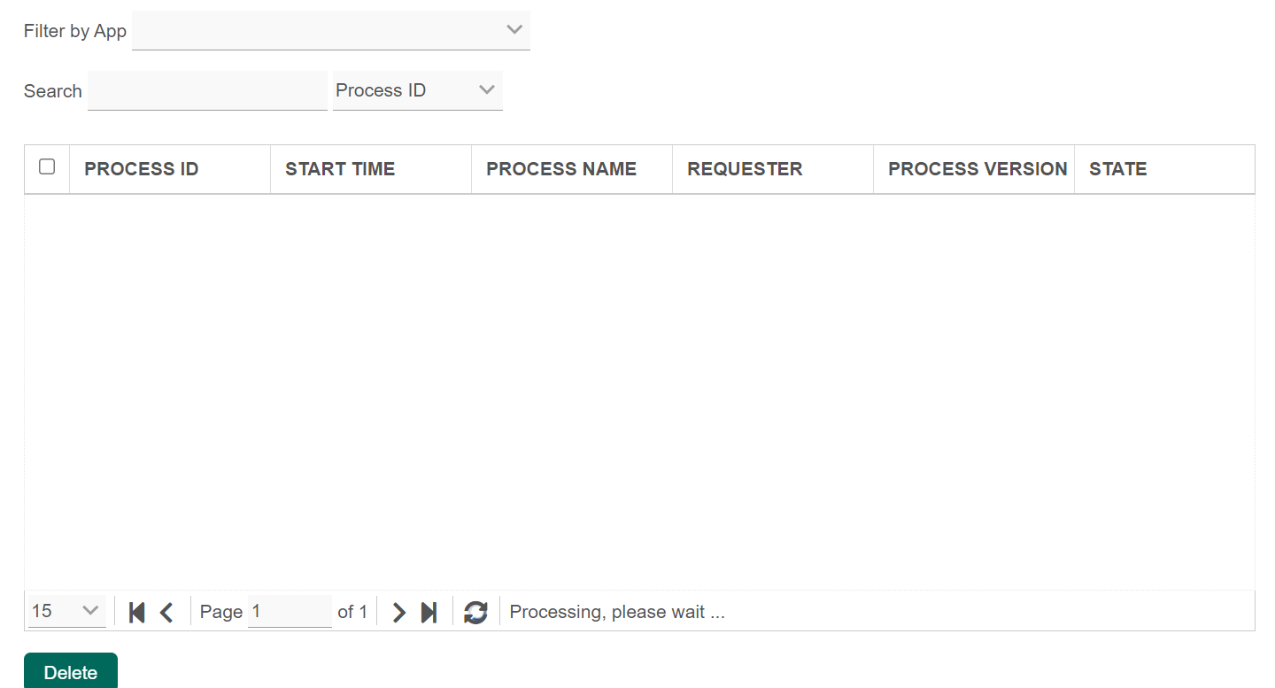

The running processes screen in Monitor does not load. It keeps on buffering. Here are the error logs that am getting.
ERROR 12 Feb 2024 17:05:01 org.joget.workflow.model.service.WorkflowManagerImpl - java.lang.Exception: Can't find entity for parameters: mgrName=null, procId=11542_DPAM_part, actId=null
1435
1436
at org.enhydra.shark.SharkUtilitiesAspect.getEntity(SharkUtilitiesAspect.java:60) ~[wflow-wfengine-7.0.31.jar:2.0-1]
1437
at org.enhydra.shark.SharkUtilities.getEntity(SharkUtilities.java:1037) ~[sharkkernel-standard-2.0.1.jar:2.0-1]
1438
at org.enhydra.shark.AdminMiscImpl.getProcessDefinitionInfo(AdminMiscImpl.java:105) ~[sharkkernel-standard-2.0.1.jar:2.0-1]
1439
I have already deleted the app DPAM but the error keeps popping up. Also deleted data related to DPAM from DB tables 'shkxpdls' and 'shkxpdldata'.
Screenshot of issue:
Inspecting the page shows a 500 in console while trying to reach an URL with /monitor/running/list.
Any help will be much appreciated.
