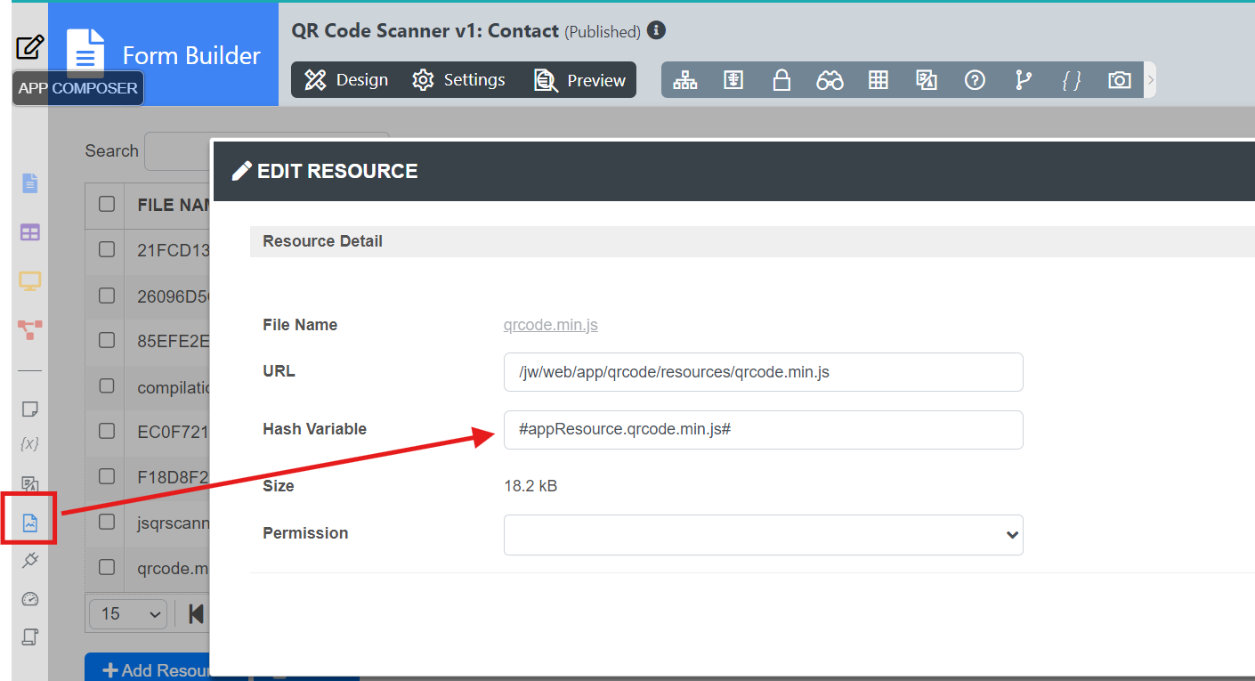

Hello,
the src="https://cdnjs.cloudflare.com/ajax/libs/jquery-qrcode/1.0/jquery.qrcode.min.js"is not accessible.
Please use another library or might as well just stick with the original code of calling QR code library from that has been added in the app that you are using . Navigate to Resources.
Thank you so much
i hope for you the best
it is working now
thanks
