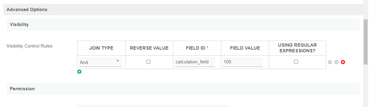

Hi Hironori, Can you check if you have enabled store as numeric value? instead of regex try giving the value directly using the "Greater than or equal to" Operator. Please refer the sample app attached demonstrating your usecase.
APP_calculationField-1-20240930120703.jwa
Hope this helps.
Hi Varnaa,
Thank you for your reply.
After viewing your sample app in the section visibility control → field value, i didn't see the "Greater than or equal to" operator.
With your sample app I have tried adding the operator in the field value and running the application, but the show or hide also didn't seem to work.

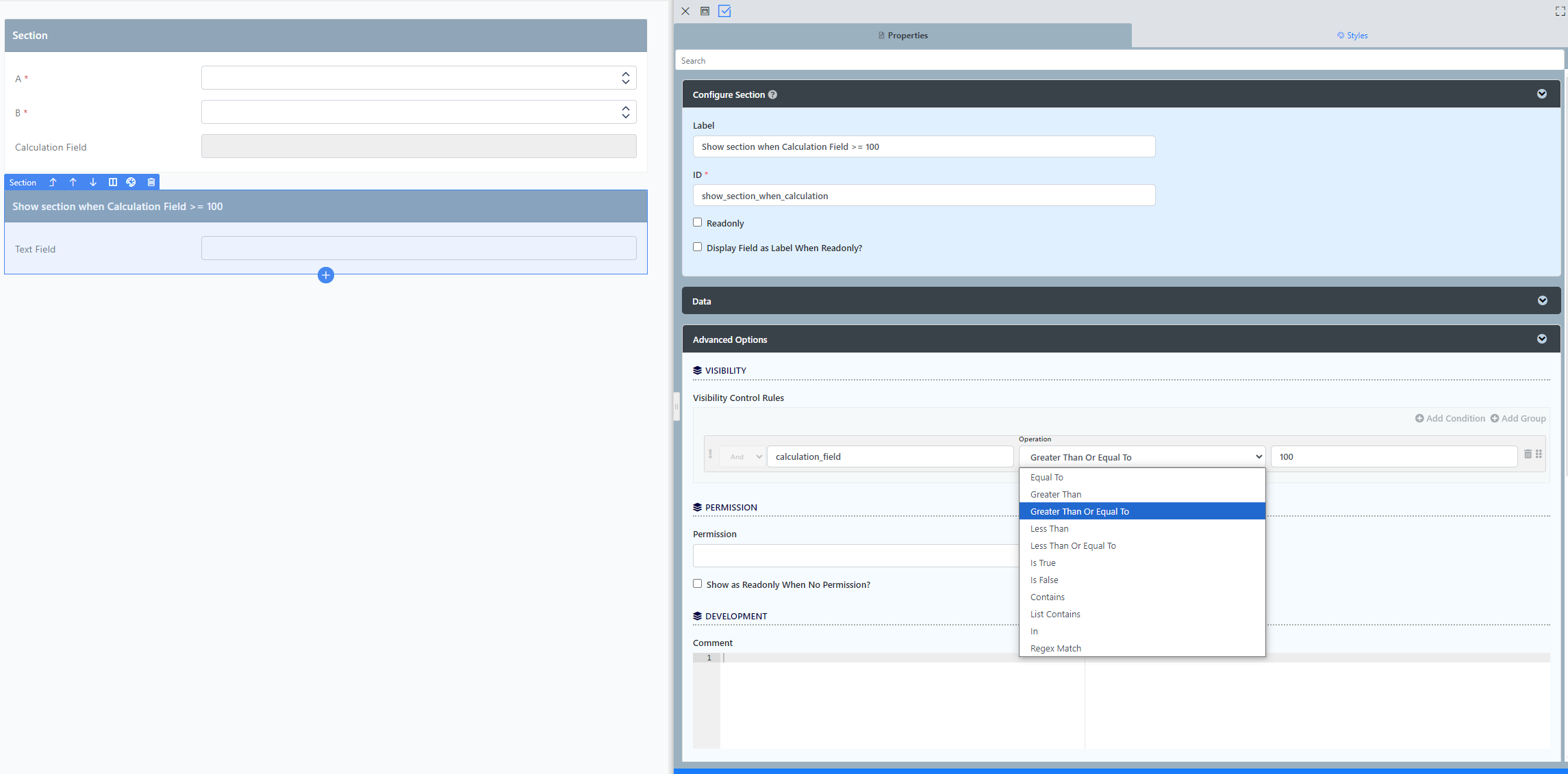

The above screenshot is from Joget version 8.1.1 which now supports operators and grouping.
Adding operator in the field value will not work as the whole string is used to compare. Can you try enabling the regex option and try ^(1\d{2}|[2-9]\d{2,}|[1-9]\d{3,})$ in the field value. Additionally you can also test and understand the regex using https://regex101.com/.

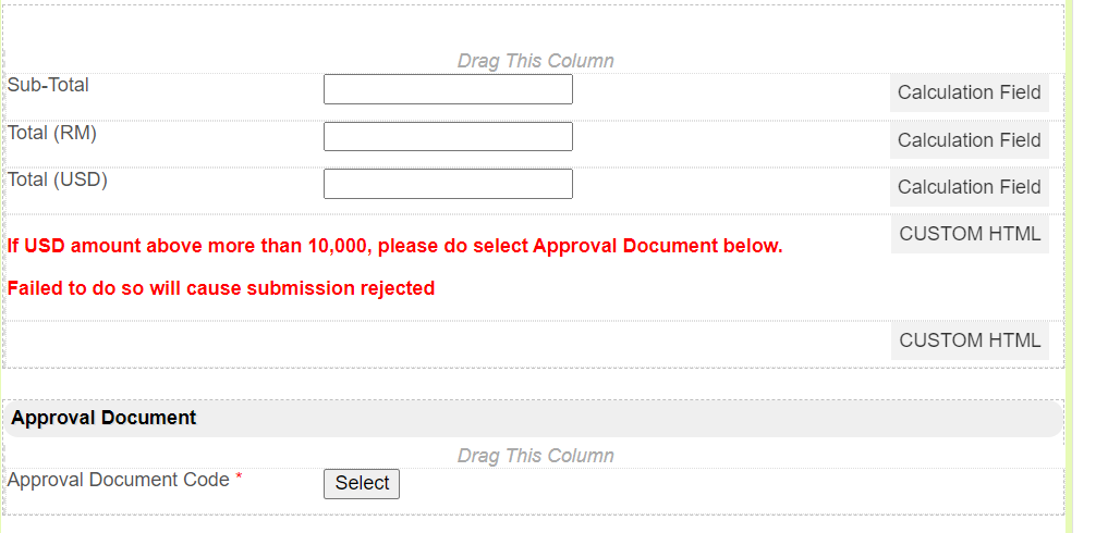

Hi experts,
I'm currently having some issues showing or hiding sections if a calculated field is greater than a certain amount.
I have tried using the regex value in the field value of the visibility control of the section that I want to show or hide, but it didn't seem to work.
any advise or some solution on getting this to work.
