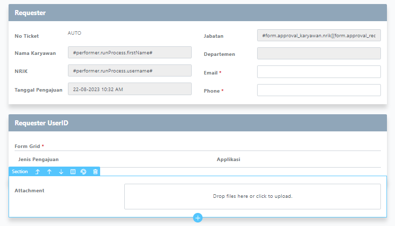

Hi, before the form has been submitted, the process has not started so there would not be any performer yet. You should try to use Subform or AJAX Subform to prepopulate the employee data.

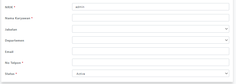

Hello, i want call employe data from app_fd_approval_employee to fill the start of run process. heres the picture.
1 Employee Form
2 Run Process form
is it possible? or i should use subform instead.
