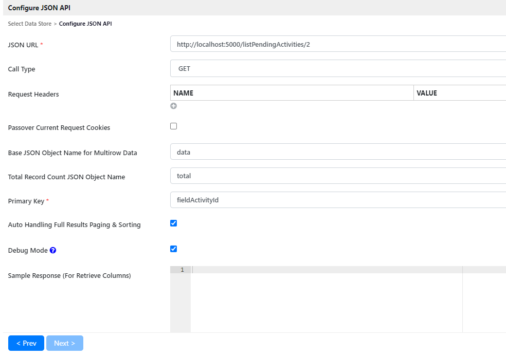

When i configure List Builder with JSON API, the Next button in Configure JSON API is disabled. I could see the log that the system pulling json data thru given URL in debug mode. my configuration as below.
Hi, I presume you are using DX 8? The Next button in disabled because there is no next screen. In DX 8, property configuration changes are applied automatically.
Base JSON Object Name for Multirow Data: data
Total Record Count JSON Object Name: total
Primary Key: fieldActivityId
REST service response:
"total": "2",
"size": "0",
"data": [
"badgeNumber": "D2732193",
"creationDateTime": "2016-07-18-14.52.11",
"scheduledDate": "2012-04-08",
"serialNumber": "2732193",
"fieldActivityId": "8633506304",
"lastReading": "0.23",
"dispatchGroupDescription": "Meter Read Team"
"badgeNumber": "D8080983",
"serialNumber": "8080983",
"fieldActivityId": "8486861486",
"lastReading": "0.78",
