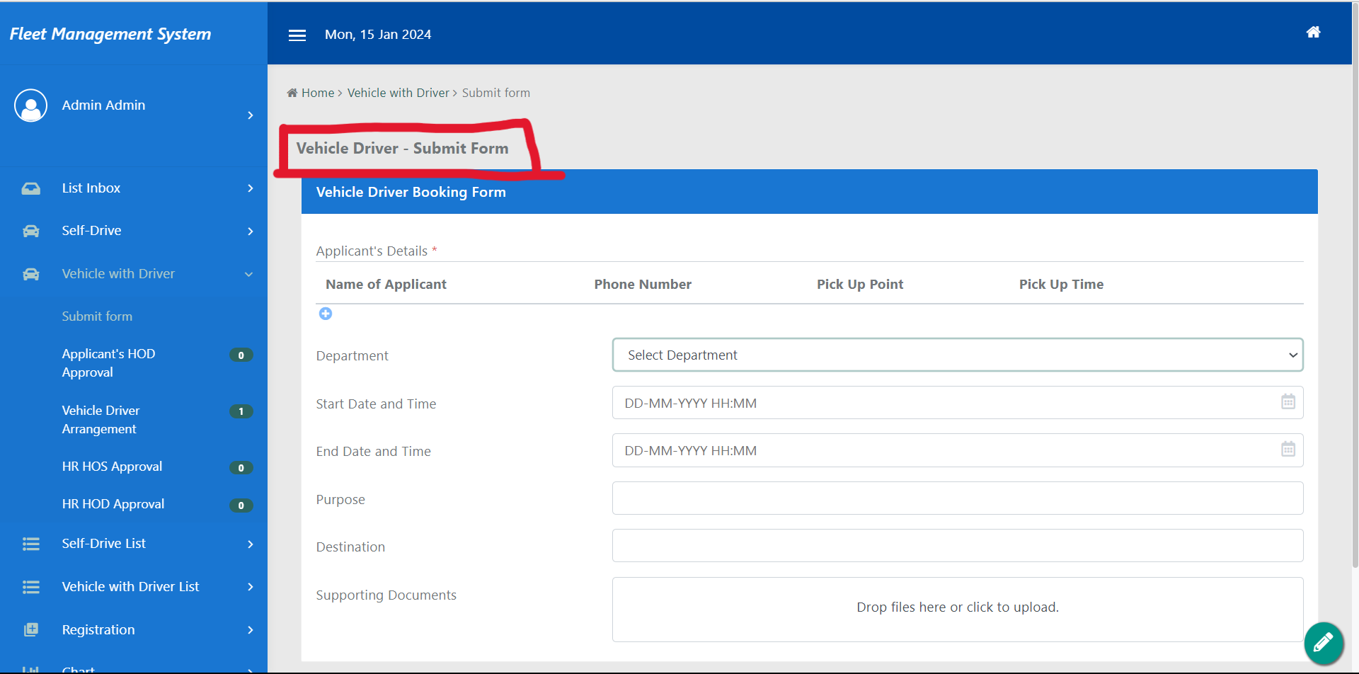

Hi, may I know if I can delete the process name "Vehicle Driver - Submit Form" in the website?

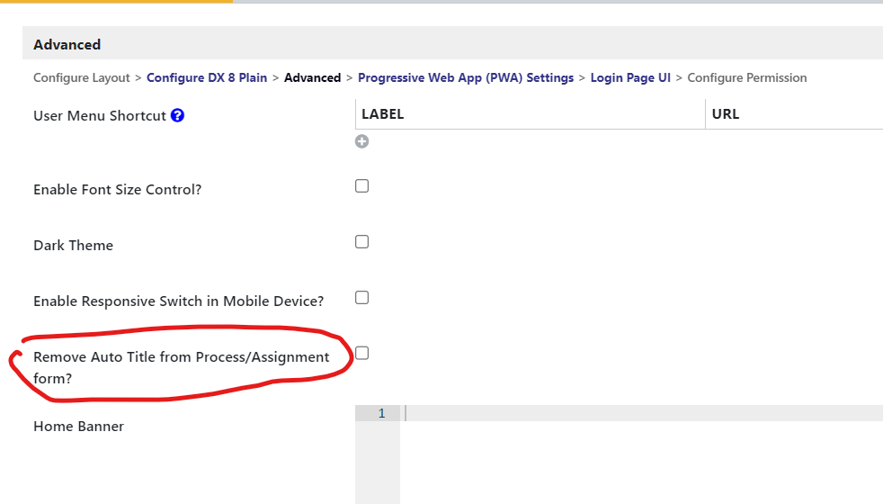

There is a property in Userview settings under Advaced tab that you need to check.Please check the pic below
