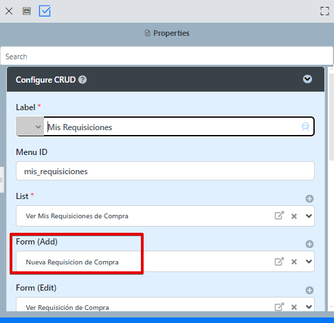

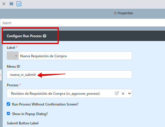

There are the configuration that I have
Run Process configuration
Crud configuration to activate New Record Button *Required to enable the Button in the Crud
Add Button Label

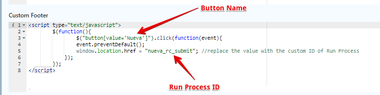

Script to redirect to run proces instead to Add Record.
Important note: Also I did the test with this code bellow and it does not work either.
$("button[value='CRUD_New']").click( function(event){ event.preventDefault(); window.location.href ="nueva_rc_submit";//replace the value with the custom ID of Run Process });
The javascript merely redirects to the run process menu, once you click it, it will open the run process menu form. Submit the form and process will start.
Add Button Label
"nueva_rc_submit"
