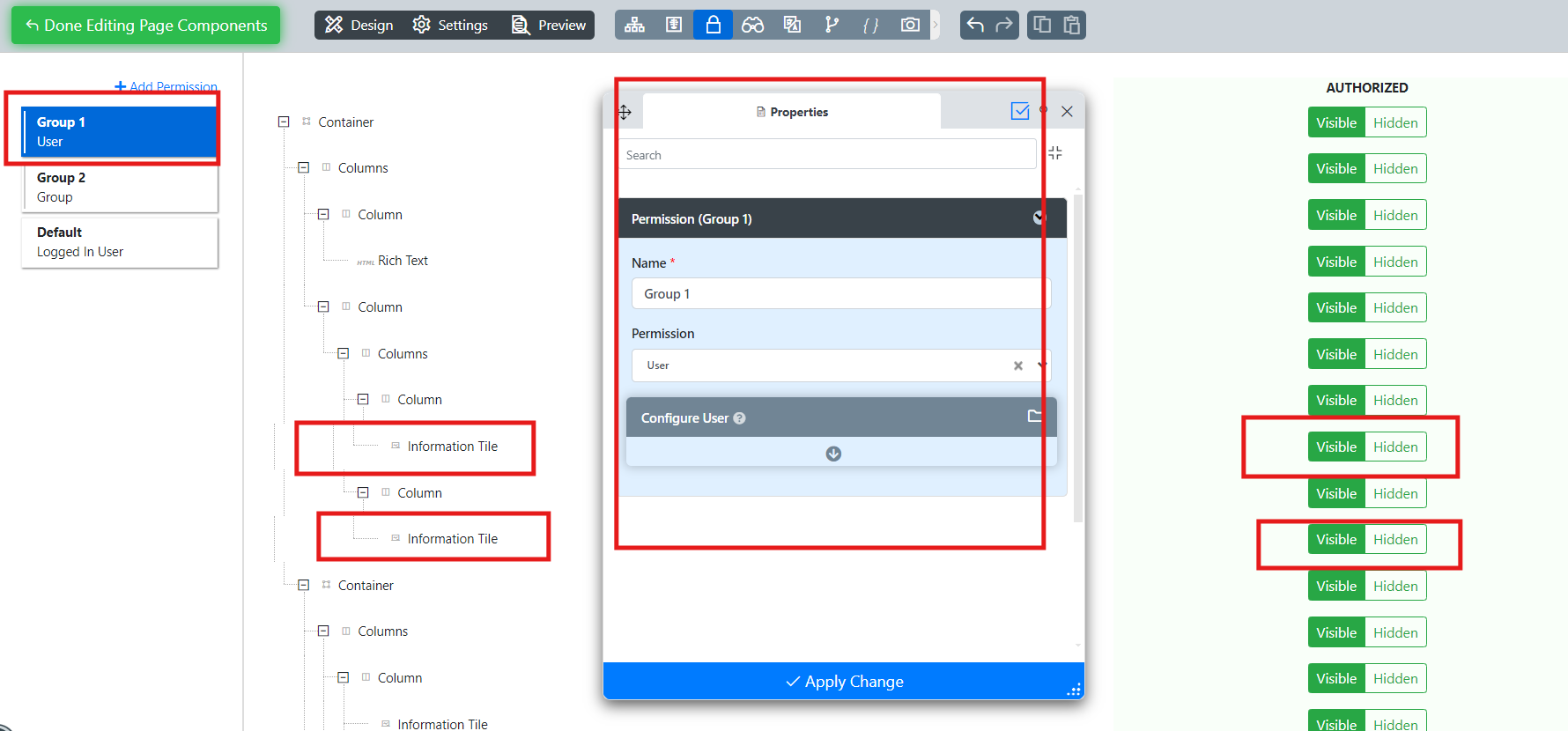

you can make use the permission in the UI Builder.
This way you can set specific information tile for the visibility of specific group of user.
Example :
Navigate to the UI Builder > Edit page Component ( Where the Information Tile is) > Click on Advanced tools (Permission ).
You san set Permission based on User type/group/Department.
read more on permission here : Permission Control
Hope it helps!
