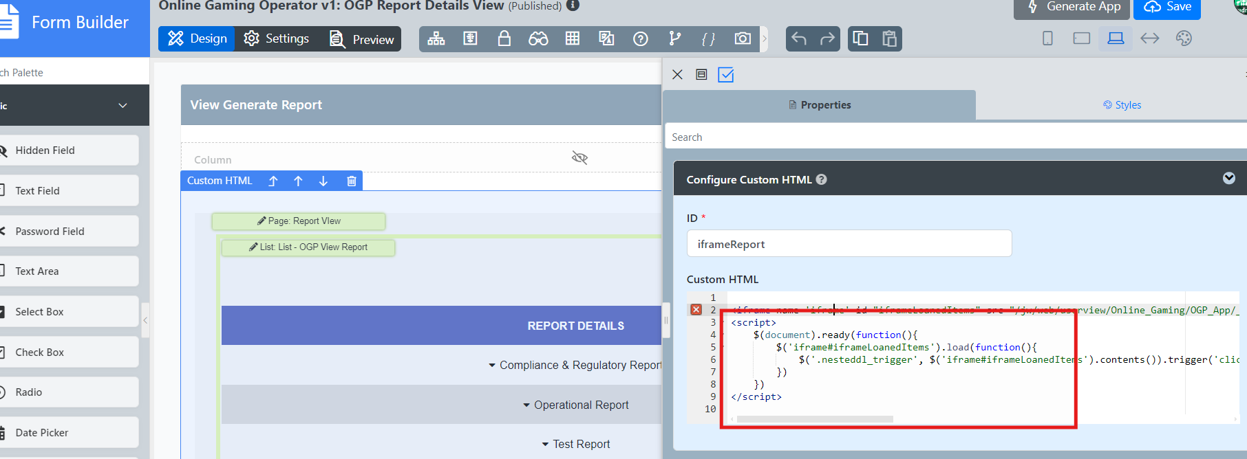

You can achieve this by adding this code in the form builder
<script>
$(document).ready(function(){
$('iframe#iframeLoanedItems').load(function(){
$('.nesteddl_trigger', $('iframe#iframeLoanedItems').contents()).trigger('click');
</script>
Thanks!

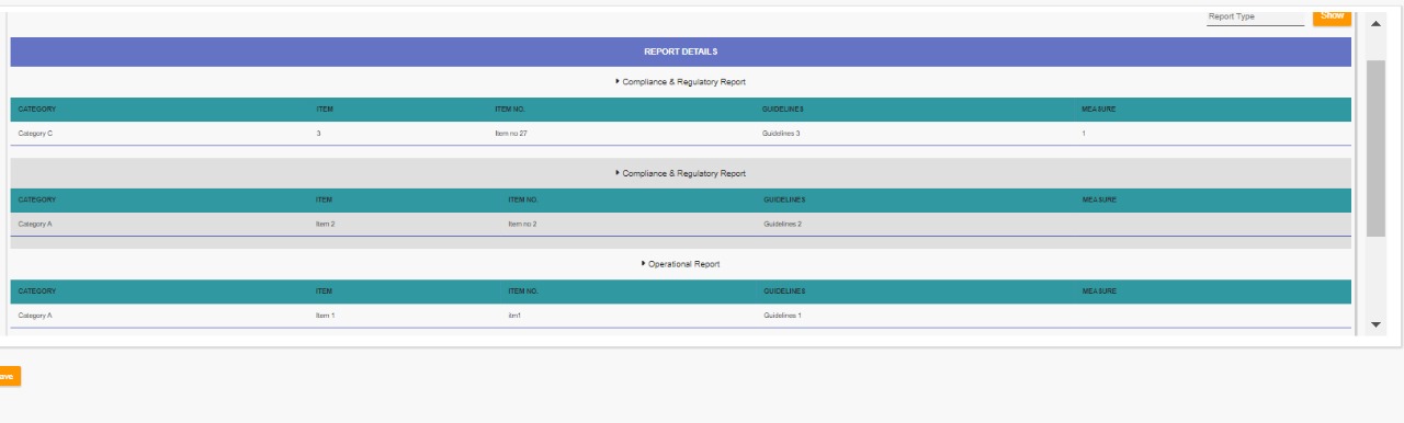

Hi Sagar,
have you downloaded the sample app?
this is the result it will open all the nested list by default. :

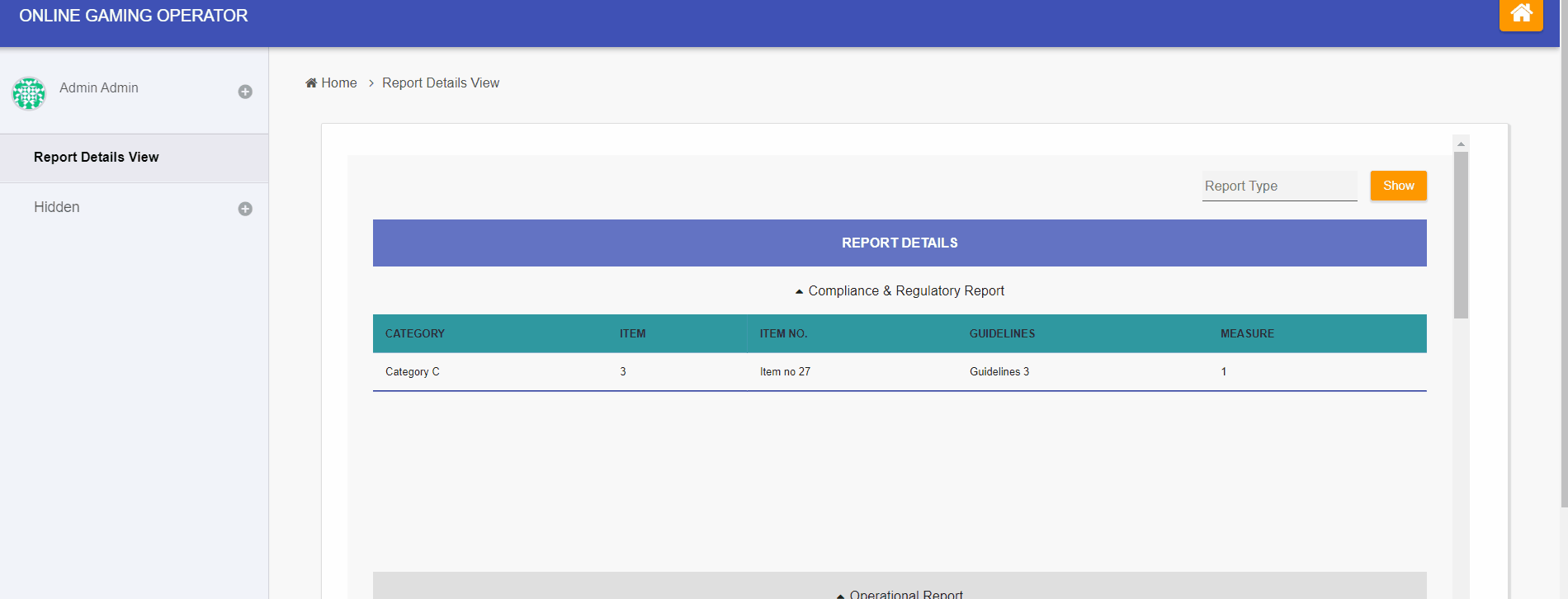

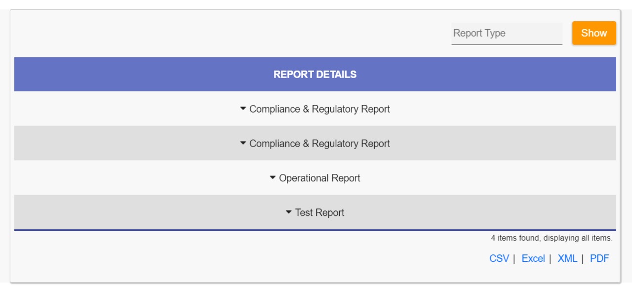

As you can see in first image all nested table is closed.
I want to default open.
