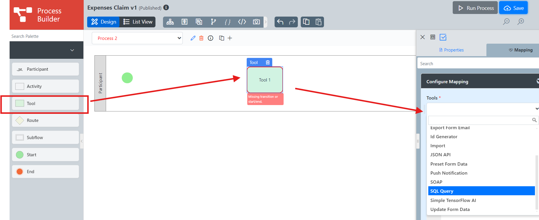

Go to the Process Builder. > Locate the SQL Query Tool element in your process flow. >

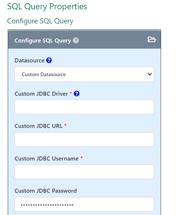

Double-click on the SQL Query Tool element to open its properties.
In the SQL Query field, you will write your SQL statement.

You can refer here for the documentation :
SQL Query Tool.
