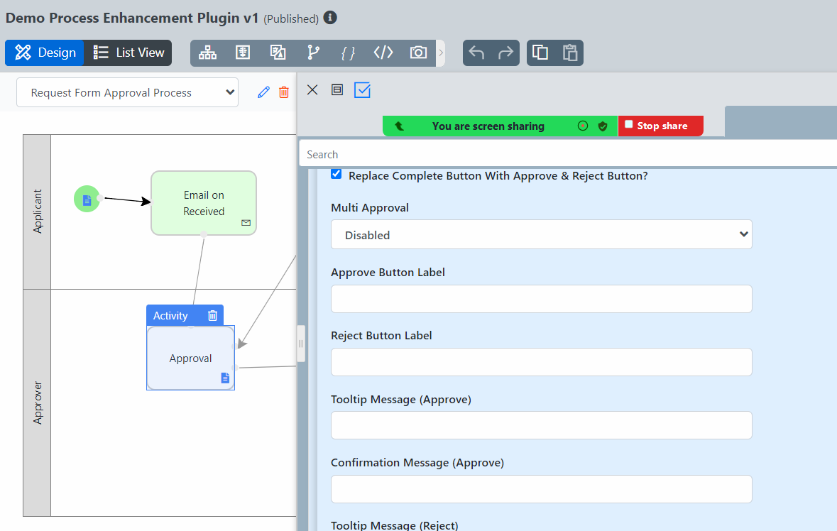

You can find all your requirement to be fulfilled in the Process Enhancement Plugin
In the link I gave you there is also a sample app>
Where you can enable Multi Approval .
Open App Composer > In the Process Builder > Click on Approval > Mapping
You can see Multi Approval Configuration.
You can leverage the Sample app to be accustomed to your liking.
Hope this will help you.
