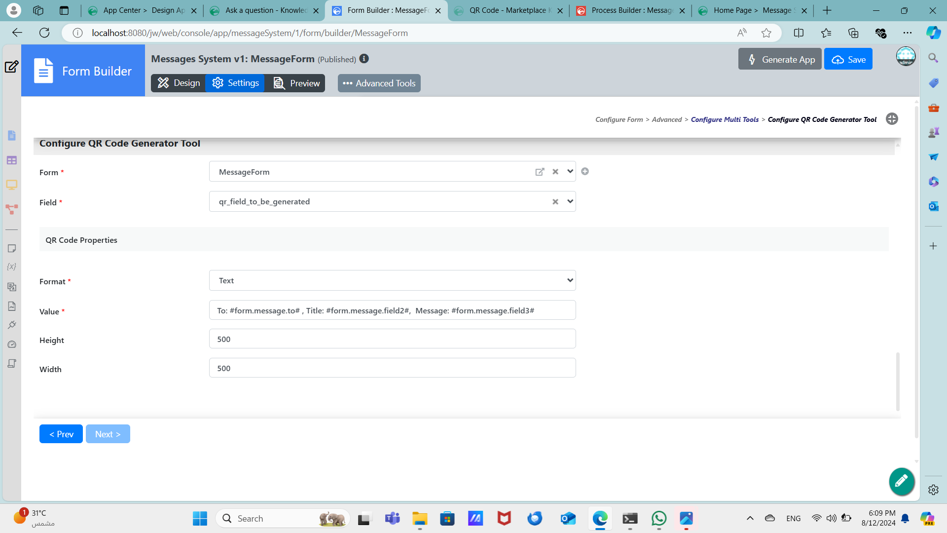

i used the qr generator tool and its work and generate the qr as a png
how to print this qr png inside the form (no longer download it at the laptop) ,
and how to let the qr code take all the values from the form
case here i put what to take
      Thank you so much
      but I would ask if there a way to let the QR code take all the values from the form
      without witting them all
      thanks so much again

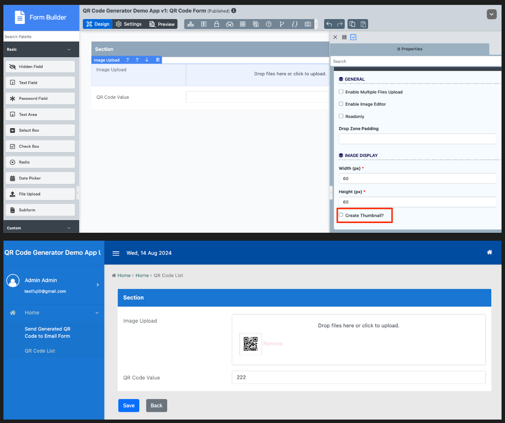

        Sorry for the late reply, you can try out this tool Joget Marketplace > QR Code Generator Tool Plugin
    2.
      Hi Nihal,
      You can change the File Upload element to Image Upload element, and make sure "Create Thumbnail" is unchecked
      Now you can view this png file inside the form. You can also utilise custom HTML to print it out as you wish.
      To retrieve values from form, you can utilise form hash variables by referring to Hash Variable - Knowledge Base for DX 8 - Joget | COMMUNITY
      Hope it helps!
