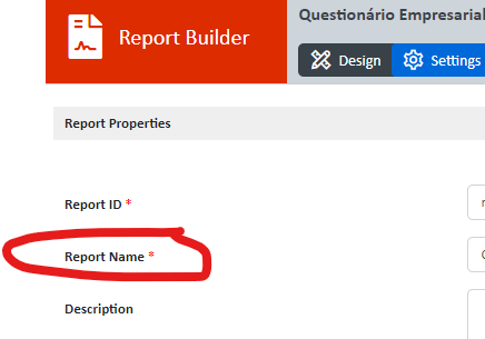

Hi there experts, is there a way to add a variable to the name of the report saved? For example what if i want to add a date to the name?

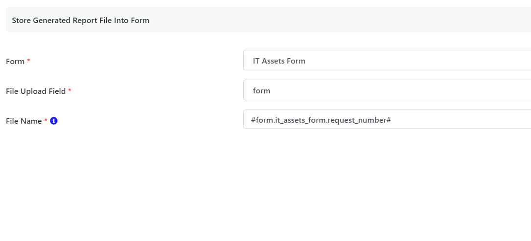

      You can customize the generated pdf name by utilizing the "File Name" field when configuring the Report Tool within a workflow or the Post Processing Tool in a form. Try using form hash variable or date hash variable based on your use case.
        Why? What's the use case? I believe that field is for app developers use to identify it when building the app. Won't be displayed in runtime for the public. It would make sense if you're using date variable either when you're using the Generate Report Tool for the filename or putting it in the Design of the report itself.
