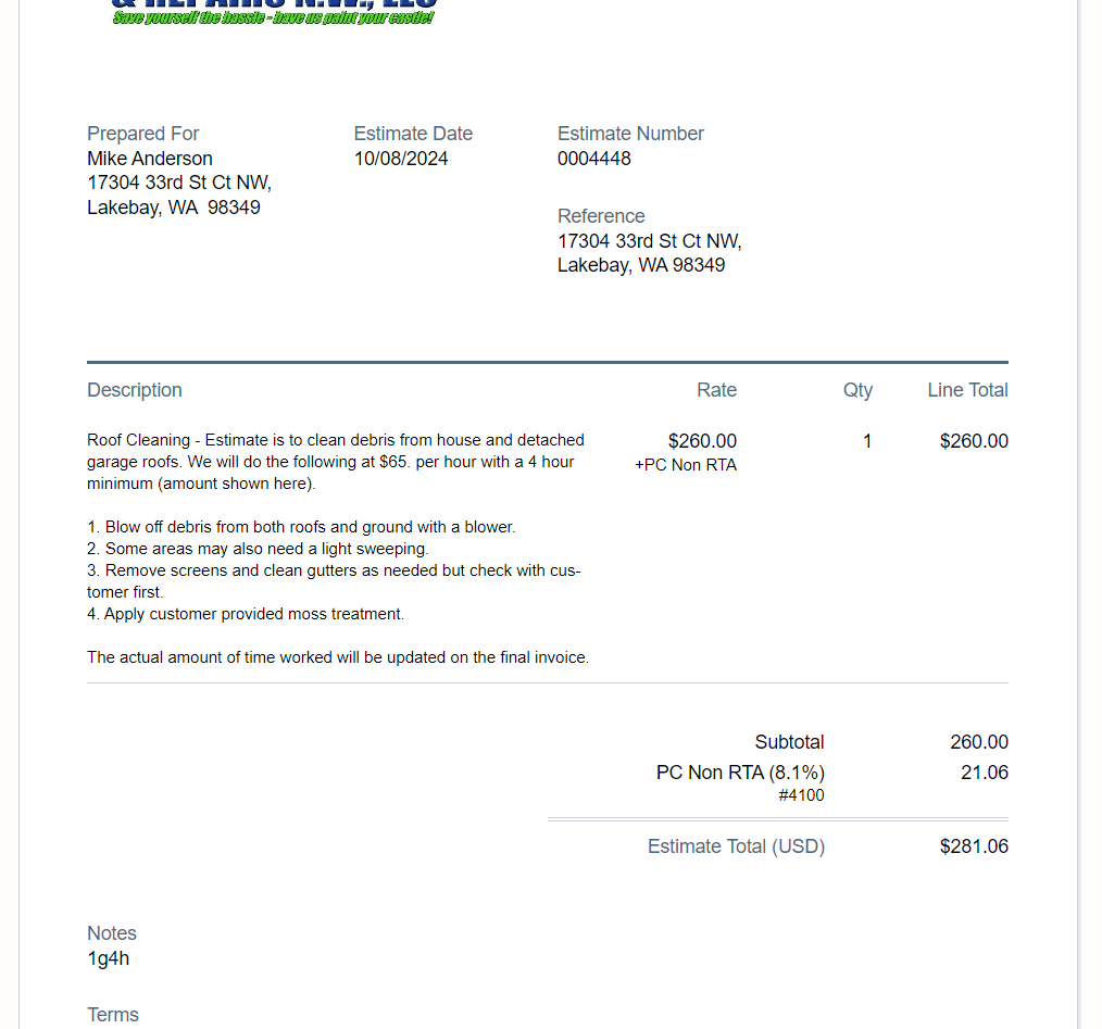

Yeah, I'm only doing the custom HTML because the owner wants the estimate they give the customer to look like this:
So how can I get that "Description" section to look like that in a grid form?
And the description section can be one or many different descriptions, so a different tables?

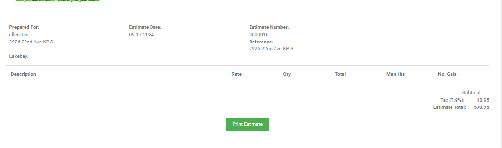

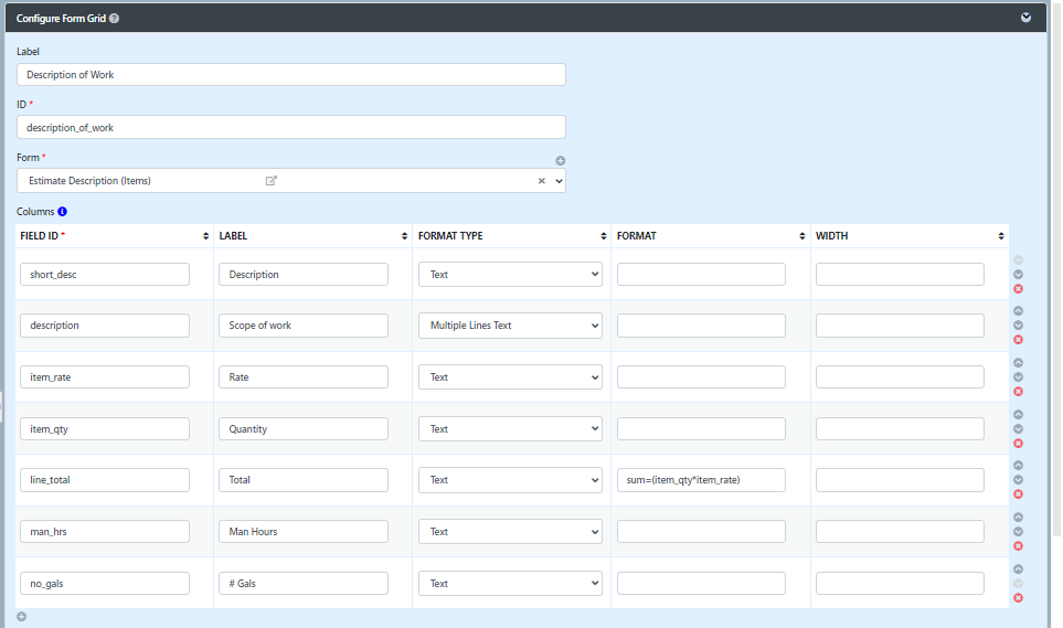

Looking to display stored data from an estimate grid form onto a custom html form to view and print. Here is the code details and editEstimate form so far: the original form ID for the edit of the estimate with the multiple items descriptions is shown here:
I get the data from to store in the estimate file fine, but the grid data doesn't populate on the custom html form. Here is a sample of the data for a test estimate:
[{"":"","item_rate":"550","description":"<p>Adding second long description here to fill up space<\/p>","id":"66e145f6-ff92-4aff-bd9d-7b5c942a97df","short_desc":"testing short desc staying power","man_hrs":"3","no_gals":"4","__UNIQUEKEY__":"ba1d1535-124a-49bb-8a4a-96293b25dcd7","item_qty":"1","line_total":"550.00"}]
the estimate print form is here:
The latest version of the custom html code:

I am not super familiar with Javascript, hash variable use and Joget, so maybe I have built this portion of the app incorrectly. Any suggestions would be appreciated.
thanks in advance for any insights...
