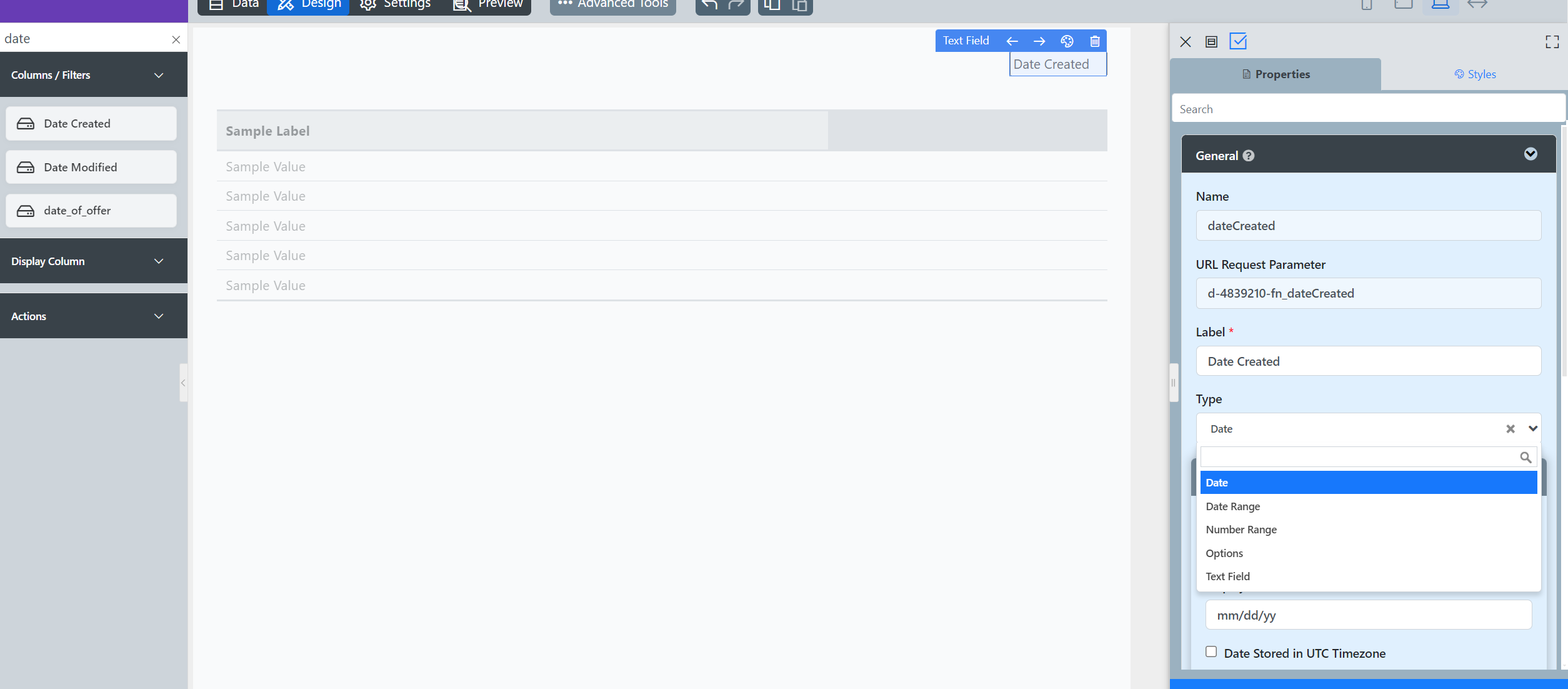

In Joget, by default joget creates and stores 2 columns in database dateCreated, dateModified

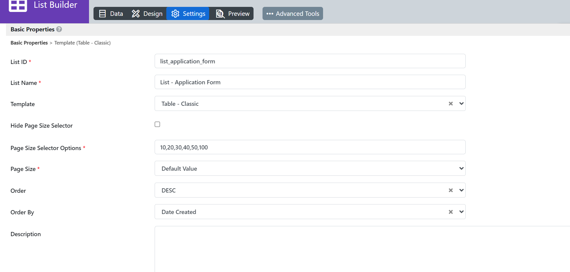

in your list you can use this column to create a filter. drag and drop the dateCreated column to the filter and set the type as date or date range. additionally u can also enable orderBy datecreated in the list settings to always show the most recent records on the top
To elaborate a bit further:
For sorting:
This setup will allow users to easily filter records by the date they were created, making it simple to find forms filled on specific dates.

how can I make a filter in UI that when u select a date it will show the information store in the date, like i fill a request form and i want find the form in UI by just entering the date that i fill the form, how can i make it
