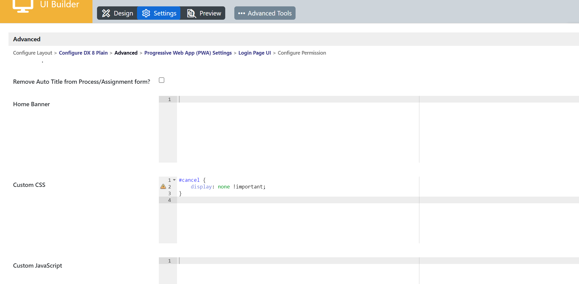

Additionally if you wish to hide this button for all forms you need to put the same code in your ui builder → Settings → Find custom css and put the code without the style tag. Hope this helps.

For entire application you can add it userview custom CSS or settings custom css

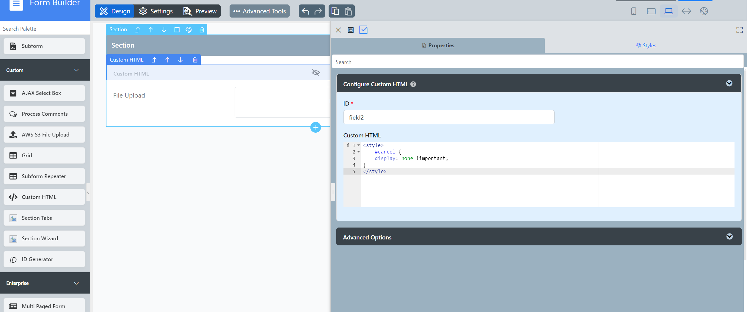

May I know where should i be placing that code?
because i tried to put in customhtml it doesn't work
maybe can you show me the screenshot
