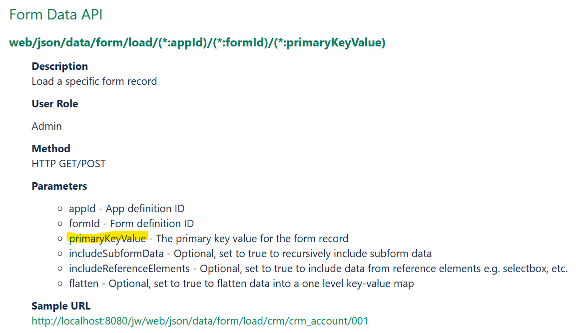

Hi everyone, I have a question regarding this form data API, may i know that what is the primary key value? how can i get the primary key value for the form record? Thanks.

      Hi Amanda, A Primary key is a unique identifier for each database table record. It ensures each record can be uniquely identified and referenced. no two records can have the same primary key.
      In Joget:
      1. You can use ID Generator Field to generate the primary key or
      2. Add a field in your Joget form, set the ID to "id" - Joget will then use the "id" value you set as the primary key.
      3. Or don't configure any field - by default Joget will generate a primary key (as shown in screenshot) for records saved in the form table
      Getting the primary key: One way is to create a datalist and add the id column which shows the primary key. Other ways would be accessing it via form data hashvariables etc. Hope this helps.
