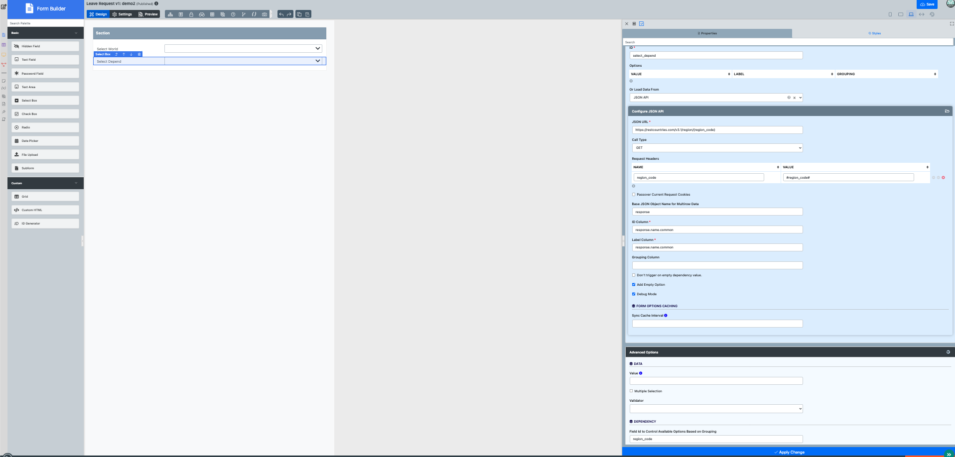

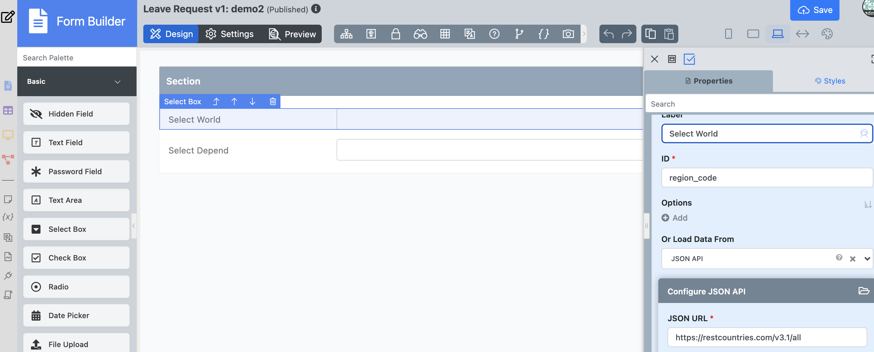

I am using Joget DX8 and need help with filtering lists based on country selection.
I have two select boxes:
  1. The first select box loads all countries from: https://restcountries.com/v3.1/all
  2. The second select box should load a filtered list based on the region code selected in the first select box from: https://restcountries.com/v3.1/region/{region}
Example: https://restcountries.com/v3.1/region/asia
I'm not sure how to pass the region value when users select from the first select box to reload the list in the second select box. I have set up the select box trigger.
Could you please guide me on how to implement this?

        Thank you very much Varnaa , your example app helped me better understand Joget. I will apply it to cases where the API returns all data.
        However, in my example, the API needs a parameter for filtering. https://restcountries.com/v3.1/regions => doesn't work This API requires a single parameter (region from API: https://restcountries.com/v3.1/all which is selected by users to filter) Example: When user selects region: Asia The API will reload with: https://restcountries.com/v3.1/region/Asia
