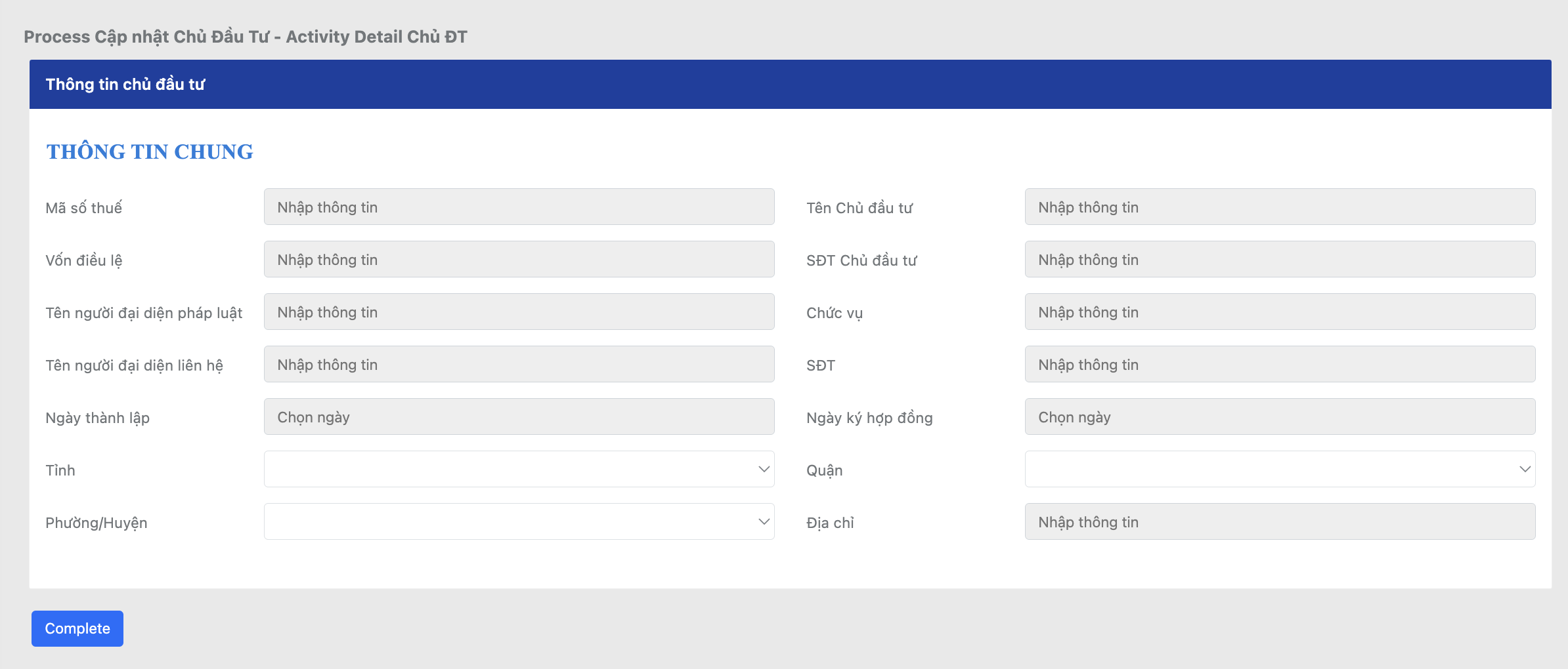

If the plugin doesn't workout for your use case could you please tell us more about how the process of this hardcoded activity id was created? Also both the screenshots seems to have data.. can you clarify what data is not loading
Activity is part of the process flow, and each process has its own unique form record ID. For the data to be properly linked in the activity, the process record ID must match the row ID that you are passing to the activity and they should share the same table name.

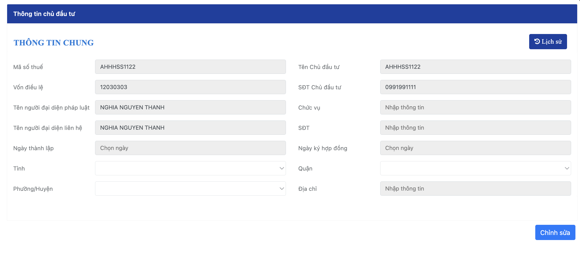

Case 1: If I drag the Form menu in and select according to the path http://localhost:8080/jw/web/userview/LoanProcessApp/loan_page/_/cap_nhat_chu_dau_tu?id=ffcfa8cb-3db7-46f4-a95f-2cbb5e3112df then the data is displayed as shown
Case 2: If I drag the Process menu in, how can I view the details?
Because if I configure http://localhost:8080/jw/web/userview/LoanProcessApp/loan_page/_/cap_nhat_chu_dau_tu_with_process?id=ffcfa8cb-3db7-46f4-a95f-2cbb5e3112df it automatically redirects to http://localhost:8080/jw/web/userview/LoanProcessApp/loan_page/_/cap_nhat_chu_dau_tu_with_process?_action=assignmentView&activityId=2013_1990_LoanProcessApp_processCapNhatChuDauTu_activity_detail_chu_dt
and doesn't show the data. Could you guide me through Case 2?

Case 1: When I click the "edit" button calling the URL: http://localhost:8080/jw/web/userview/LoanProcessApp/loan_page/_/cap_nhat_chu_dau_tu?id=ffcfa8cb-3db7-46f4-a95f-2cbb5e3112df The data automatically loads into the form for me => OK
Case 2: I want to record update history, so I created a process to handle it. When I click the "edit" button calling the URL: http://localhost:8080/jw/web/userview/LoanProcessApp/loan_page/_/cap_nhat_chu_dau_tu?_action=assignmentView&activityId=2013_1990_LoanProcessApp_processCapNhatChuDauTu_activity_detail_chu_dt&id=ffcfa8cb-3db7-46f4-a95f-2cbb5e3112df But the data doesn't load, and the activity ID is hardcoded.
