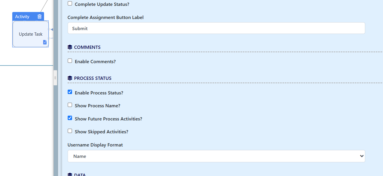

Hi Haldun, here are few things you can check to see identify why its not working:
1. Process Formatter Configuration: Verify that the process formatter is correctly applied to the record ID or table ID that's being used for your process requests.
2. Check your process settings in activities to make sure you have enabled process status tracking
3. Review the process definition to ensure it contains sufficient trackable activities & Check the process logs / monitor for any execution errors that might have caused process abort.
Hope this helps. Feel free to reach out if you have further questions.

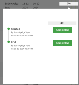

we just implemented Joget Process status in our Datalist, showing a one step process (start-to-end) but doesn't indicate status bar as %100 completed.
Any help to improve our status Level as expected showing up on completion (%100, full green color bar)
