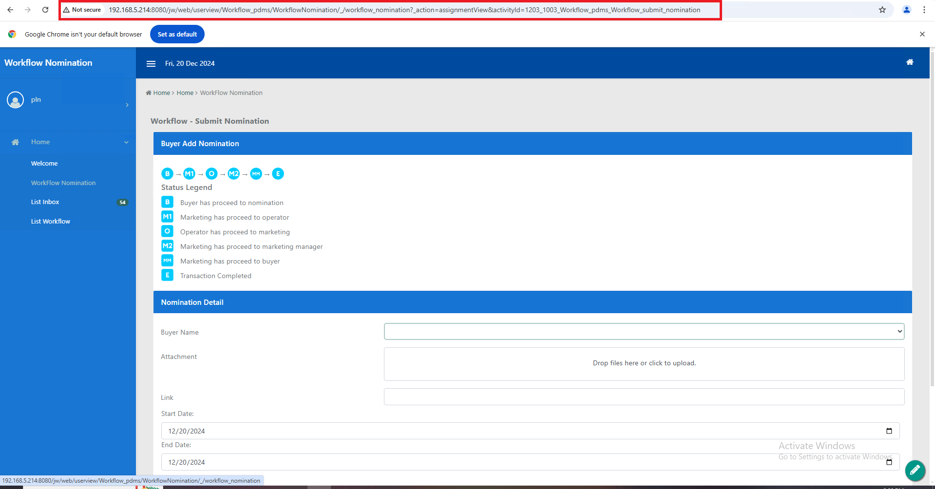

      How can I get the activityid or display the corresponding view without the menu (embedded view), either using an iframe or another method?

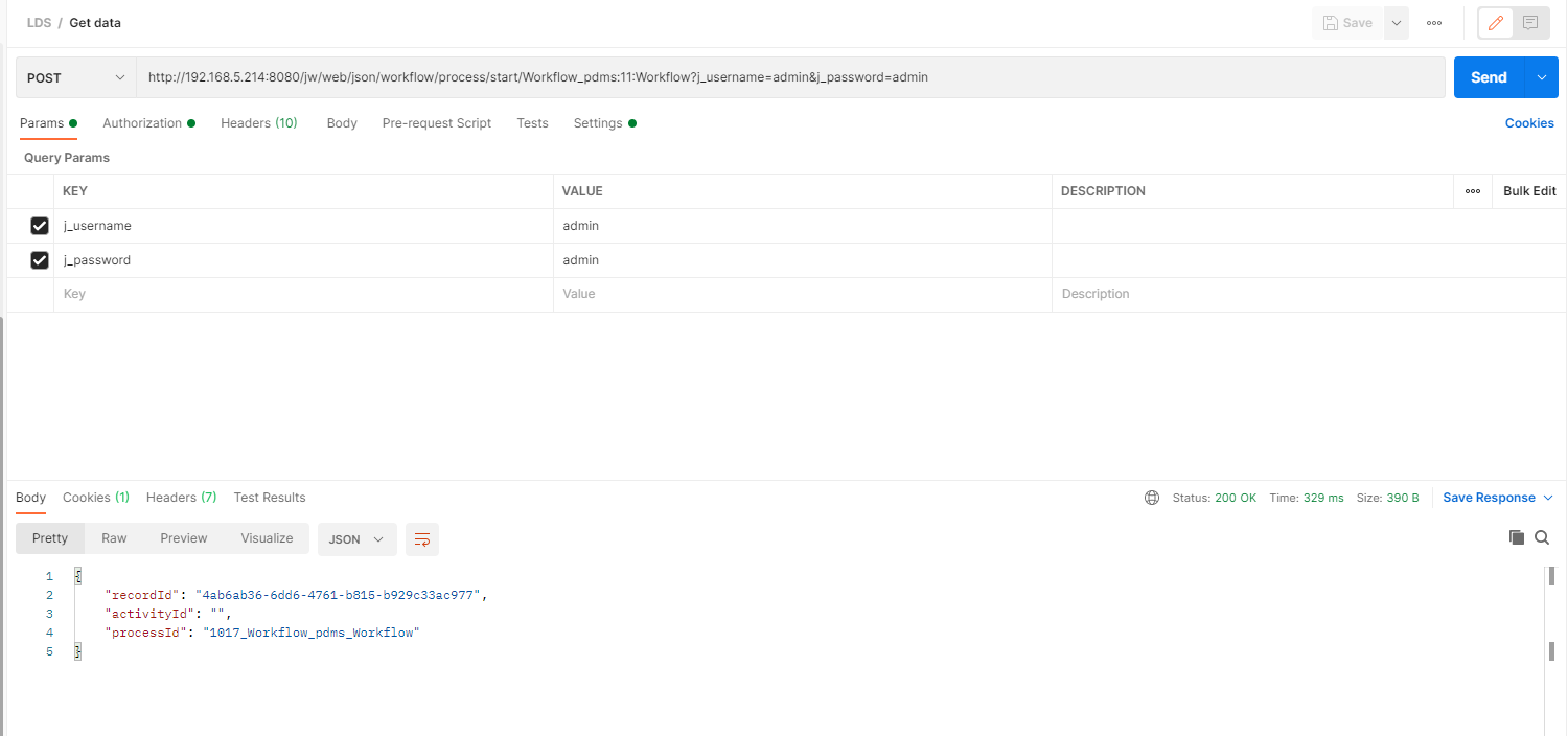

      I tried using Postman, but the activityid is empty. Is there anything that needs to be configured?

        You are starting a process instance as user X, if the next assignment belongs to the same user X, and in process builder, you have "show next assignment" in "green start bubble", then "activityId" will get populated.
