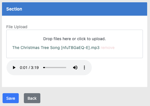

Could guide me how to play audio files?
      Hello, after adding a File Upload field with an uploaded mp3 file, you can try this script in Custom HTML.
      <ul class="form-fileupload-value">
          <li>
              <audio controls>
                  <source src="/jw/web/client/app/<REPLACE APP ID>/1/form/download/<REPLACE FORM ID>/<REPLACE RECORD ID>/<REPLACE MP3 FILE NAME>.mp3.?attachment=true" type="audio/mpeg">
                  Your browser does not support the audio element.
              </audio>
          </li>
      </ul>
