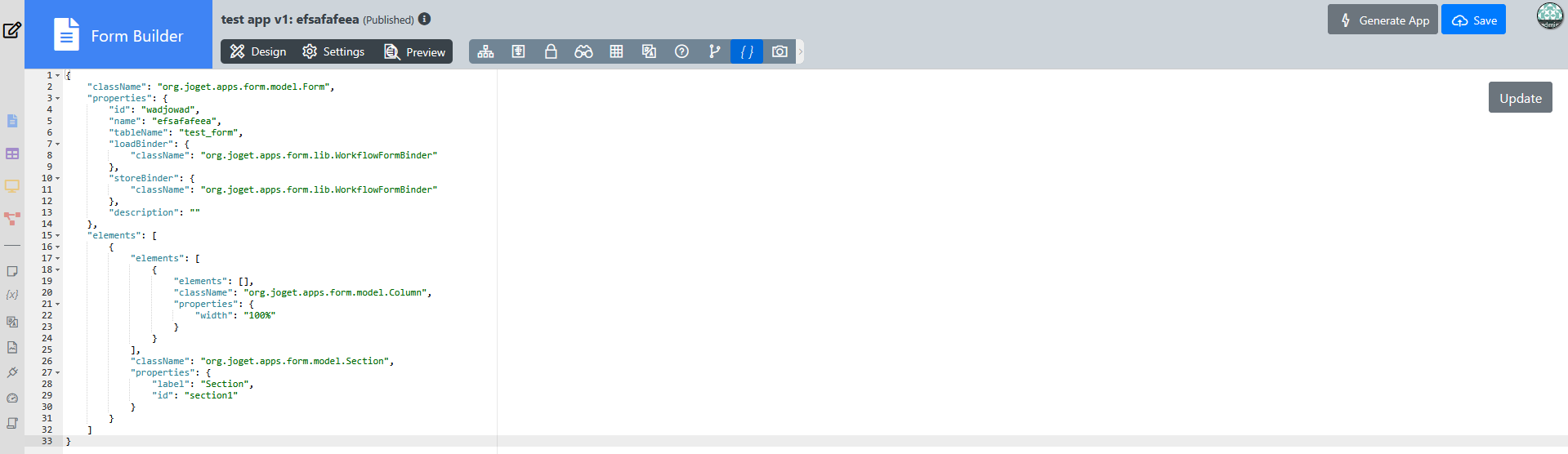

    In Form Builder expand Advanced Tools, there you'll find JSON Definition. Click on it.
    Notice how there are 3 element keys (line 15, 17, 19). What will impact the design and preview of the form is the element key in line 19, that is the line which content we must fill.
    Inside of the squared brackets, paste the following code:

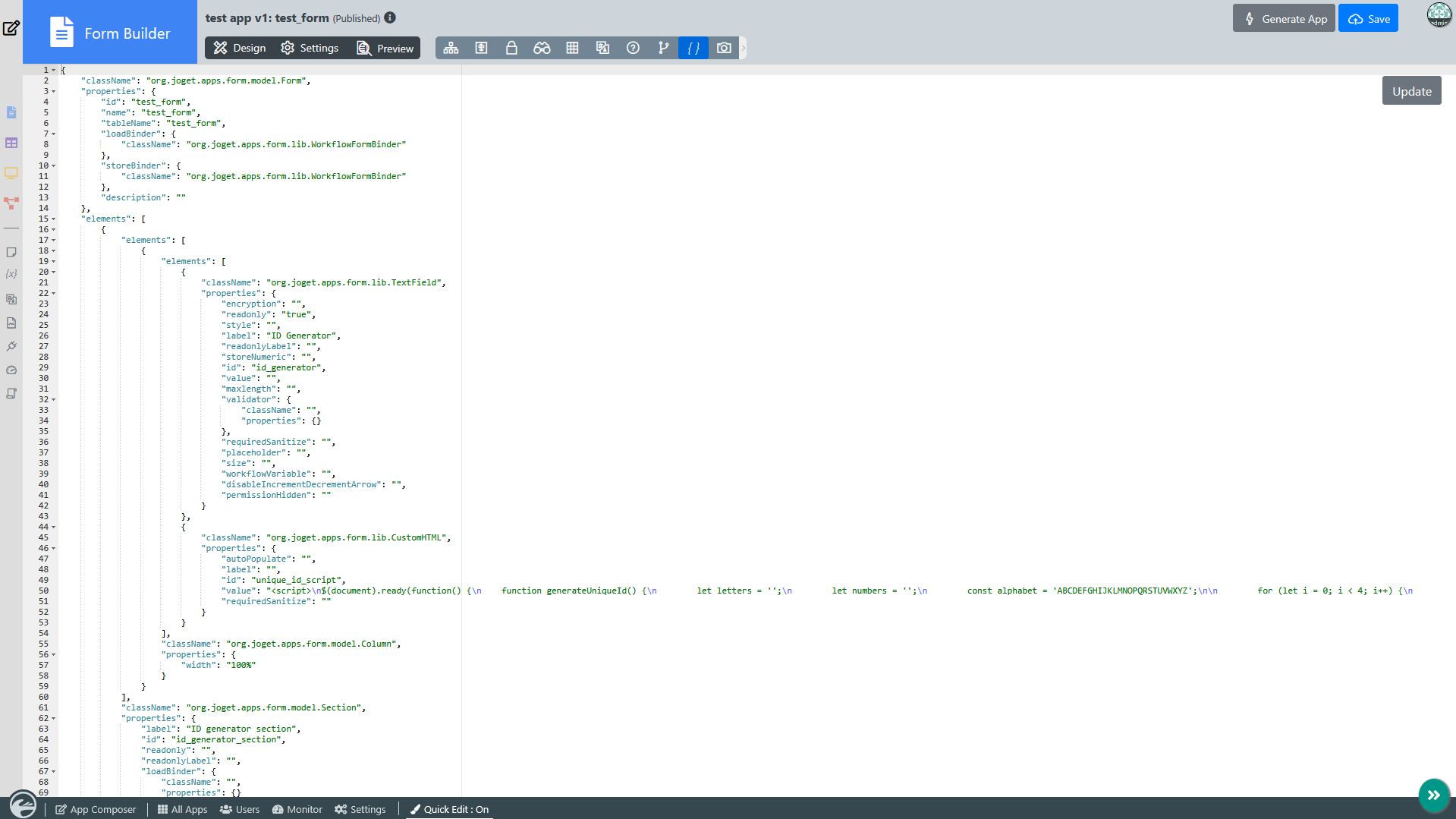

                  "className": "org.joget.apps.form.lib.TextField",
                  "properties": {
                    "encryption": "",
                    "readonly": "true",
                    "style": "",
                    "label": "ID Generator",
                    "readonlyLabel": "",
                    "storeNumeric": "",
                    "id": "id_generator",
                    "value": "",
                    "maxlength": "",
                    "validator": {
                      "className": "",
                      "properties": {}
                    "requiredSanitize": "",
                    "placeholder": "",
                    "size": "",
                    "workflowVariable": "",
                    "disableIncrementDecrementArrow": "",
                    "permissionHidden": ""
                  "className": "org.joget.apps.form.lib.CustomHTML",
                  "properties": {
                    "autoPopulate": "",
                    "label": "",
                    "id": "unique_id_script",
                    "value": "<script>\n$(document).ready(function() {\n    function generateUniqueId() {\n        let letters = '';\n        let numbers = '';\n        const alphabet = 'ABCDEFGHIJKLMNOPQRSTUVWXYZ';\n\n        for (let i = 0; i < 4; i++) {\n            letters += alphabet.charAt(Math.floor(Math.random() * alphabet.length));\n        }\n\n        for (let i = 0; i < 4; i++) {\n            numbers += Math.floor(Math.random() * 10);\n        }\n\n        return letters + numbers;\n    }\n\n    setTimeout(function() {\n        var $field = $('#id_generator');\n        if ($field.length && $field.val().trim() === '') {\n            $field.val(generateUniqueId());\n        }\n    }, 500);\n});\n</script>",
    Format the previous code to look neatly with the rest of the code, it should look something like this:

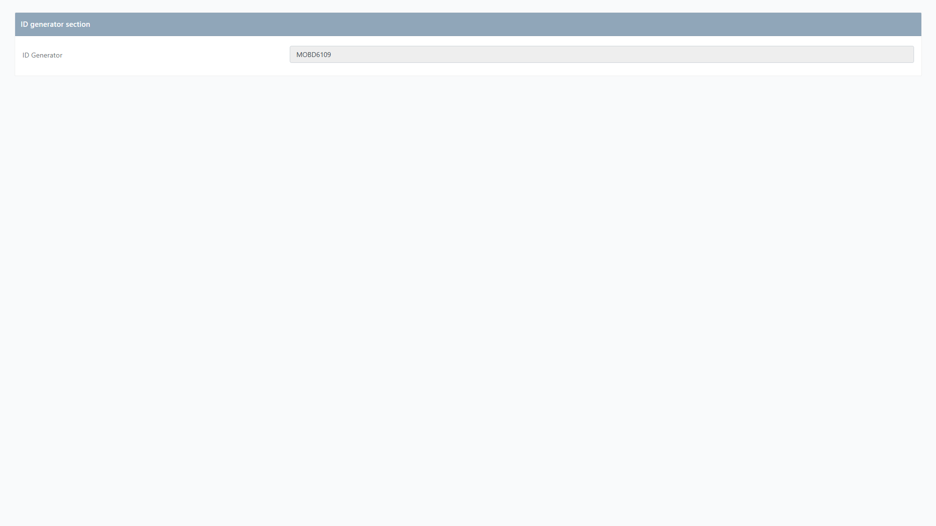

    Do note that the Label and ID of each element are just examples, you could rename as you see fit.
    Preview the form and there we have it! A text field that generates random 8 digits code, with 4 digits of alphabetical characters followed by 4 other numeric characters.

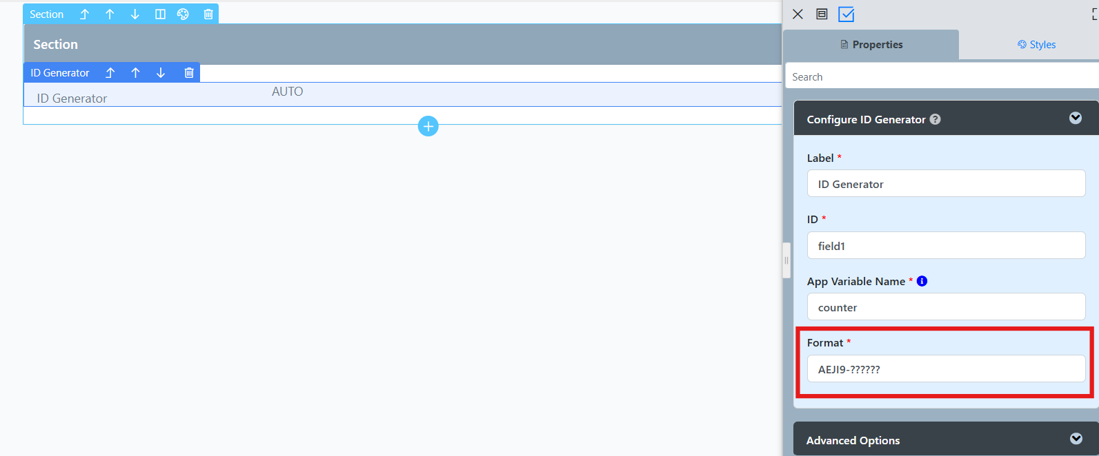

      You can still achieve a unique ID with a specific Prefix using the ID generator; otherwise if you are trying to add records into a table with a particular format of ID using Custom HTML, then that can be done another way. Please elaborate.
