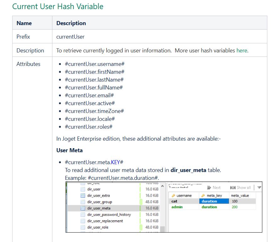

      You should be able to implement this by refering to AJAX Subform, but to make sure to retrieve current users data, I would probably add a hidden field (username) and then make the value of this field fetch the value from the following hashvariable, so that I can use it in the ajax subform to retrieve the user's information.
