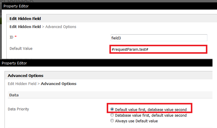

This is an expected behaviour as when the form is in read only mode, there's no logical reason to save the form data.
You may try to use a hidden field instead. Make sure that you tweak the settings accordingly so that the value you set will get the precedence to be saved first.

You will need to use a hidden field instead of text field. It's the same reason I stated above, as it is a read only field, value set will not be saved.
Anyway, you should think of other alternative if you want the value set to be non-editable as you are setting via URL parameters which is not fool-proof after all.
