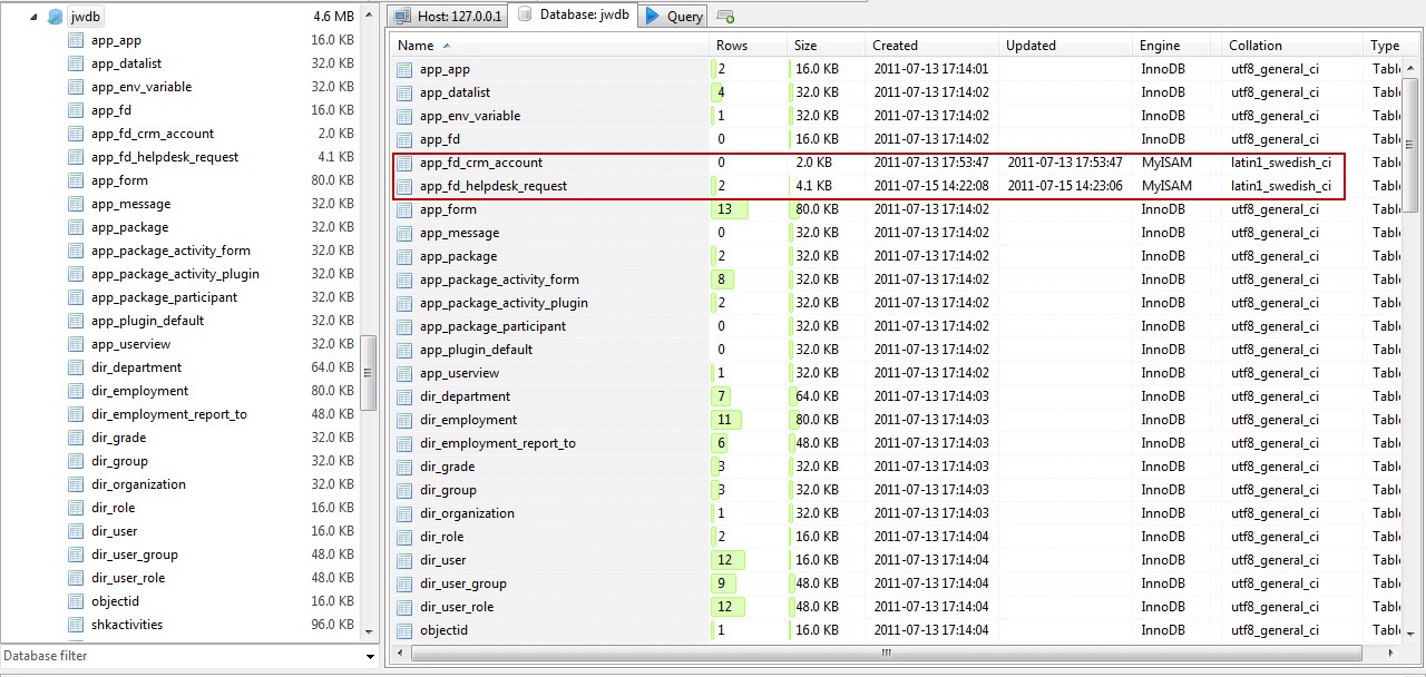

Is this a database you created yourself?
The problem with your database is, the default character set is not set to UTF8. So, new form table automatically created by Form Builder is set with non-UTF8 character set. The following screenshot shows a sample of the issue you are facing.
The default database installed together by Joget Workflow v3 installer is already set to UTF8 character set by default.
Thus, what you can do is, alter the default character set of jwdb and the affected app_fd_ tables using the following MySQL commands:
