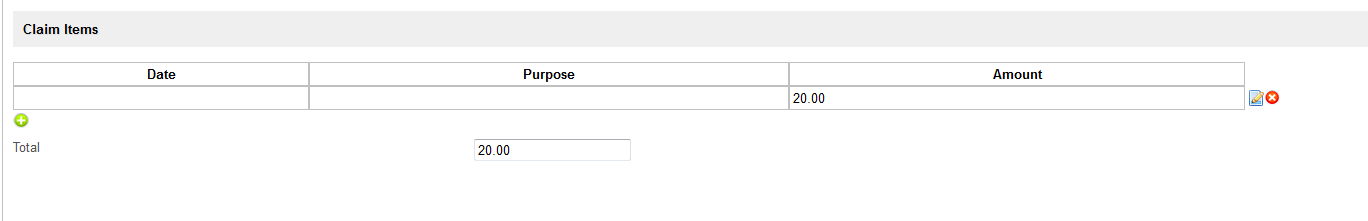

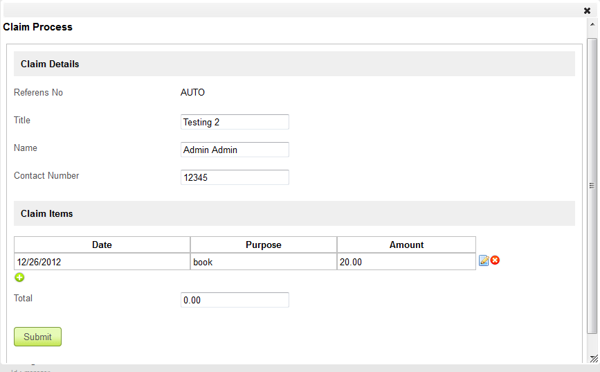

Hey expert! I'm really new with Joget. I do exactly like the tutorial but after I enter the amount, there is no output for total. It's like the total didn't read the amount.
Really need your help. Sorry. It's kinda simple thing but I seriously have no idea. Thanks in advance :)

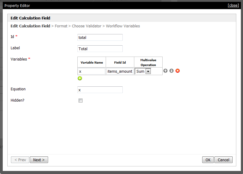

Hi Suliss,

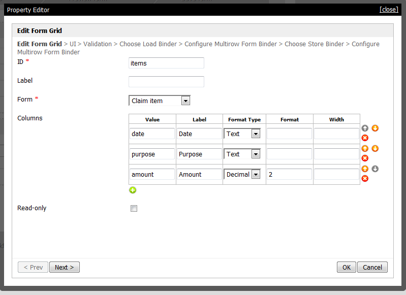

You have mis-configured your Calculation Field's variables. You should write "items.amount" and not "items_amount".
